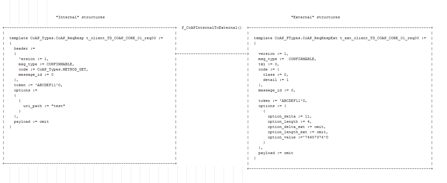

Fuzzing CoAP adheres to the same principles as MQTT presented previously, but has some twists and turns that call for some explanation.
First of all, the "delta" encoding of option_delta and option_length cannot be handled by RAW as of today, so a
new protocol module has been written based on RAW which can handle the encoding direction only and this should be sufficient for fuzzing,
assuming that decoding is done with the legacy (handwritten) decoder.
However, the structures declared in CoAP_Types.ttcn and in CoAP_FTypes.ttcn are different: the first ones are optimized for easiness of use,
while the second ones to enable fuzzing.
Let's call structures in CoAP_Types "Internal" and those in the CoAP_FTypes "external".
For instance a confirmable GET expressed in the first approach ("Internal") looks like this:
template CoAP_Types.CoAP_ReqResp t_client_TD_COAP_CORE_01_req00 :=
  header :=
    version := 1,
    msg_type := CONFIRMABLE,
    code := CoAP_Types.METHOD_GET,
    message_id := 0
  token := 'ABCDEF11'O,
  options :=
      uri_path := "test"
  payload := omit
but the equivalent one described with the second approach ("External") like this:
template CoAP_FTypes.CoAP_MessageExt t_ext_err_client_TD_COAP_CORE_01_req00 :=
{msg:=
    version := 1,
    tkl := 0,
    code := {
      class := 0,
      detail := 1
    message_id := 0,
    options := {
        option_delta := 11,
        option_length := 4,
        option_delta_ext := omit,
        option_length_ext := omit,
        option_value :='74657374'O
    payload := {
      payloadMarker := 'FF'O,
      payload := 'AA'O
The first one is more user friendly, but misses a number of fields that are automatically calculated by the handwritten encoder which are of interest
for fuzzing hence made visible in the second set of structures.
The recommended workflow then is to write some "master" templates based on the "internal" types and convert them into "external" types using
f_CoAPInternalToExternal():
index.php/fa/28992/0/
Note: "Internal" templates will have to be written with the options in increasing order of option number, then converted to "External" templates (else conversion will result in an error).
"External" types then can be fuzzed using the technique presented.

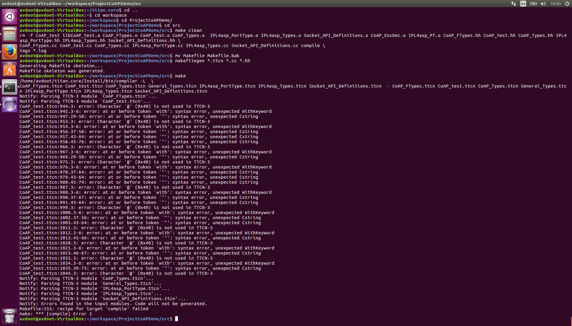

Re: Using Titan as a fuzzing engine part 3 [message #1763479 is a reply to message #1759086] Tue, 16 May 2017 10:08 Go to previous messageGo to next message
Hi Elemer Lelik,
I tried to build this project but it gave me an error stating ' error: Character '@' is not used in TTCN-3'. And my compiler version is CRL 113 200/6 R1A. Where i am going wrong?
Thank You in Advance!
With Regards,
Avdoot Chalke
  • Attachment: error.png
    (Size: 389.01KB, Downloaded 165 times)
Re: Using Titan as a fuzzing engine part 3 [message #1763481 is a reply to message #1763479] Tue, 16 May 2017 10:51 Go to previous messageGo to next message
Hi Avdoot,
as I mentioned in the first part of the series
Using Titan as a fuzzing engine part 1
https://www.eclipse.org/forums/index.php/t/1085150/
this is a brand new feature added only in post 6.1.0 releases of Titan;
please build the latest Titan from source as per instructions in github/README.linux

Re: Using Titan as a fuzzing engine part 3 [message #1763484 is a reply to message #1763481] Tue, 16 May 2017 11:08 Go to previous messageGo to next message
Hi Elemer Lelik,
I performed all the steps given in README.linux
'https://github.com/eclipse/titan.core/blob/master/README.linux'
But still it gives me this error.
My environmental variables are
rintenv | grep TTCN
TTCN3_DIR=/home/avdoot/titan.core/Install
avdoot@avdoot-VirtualBox:~/titan.core/Install$ printenv | grep PATH
MANPATH=:/home/avdoot/titan.core/man:/home/avdoot/titan.core/man:/home/avdoot/titan.core/Install/man
LD_LIBRARY_PATH=:/home/avdoot/titan.core/lib:/home/avdoot/titan.core/lib:/home/avdoot/titan.core/Install/lib
XDG_SESSION_PATH=/org/freedesktop/DisplayManager/Session1
XDG_SEAT_PATH=/org/freedesktop/DisplayManager/Seat0
DEFAULTS_PATH=/usr/share/gconf/ubuntu.default.path
PATH=/home/avdoot/bin:/home/avdoot/.local/bin:/usr/local/sbin:/usr/local/bin:/usr/sbin:/usr/bin:/sbin:/bin:/usr/games:/usr/local/games:/snap/bin:/home/avdoot/titan.core/bin:/usr/lib/jvm/java-8-openjdk-amd64/bin:/home/avdoot/titan.core/bin:/home/avdoot/titan.core/Install/bin
MANDATORY_PATH=/usr/share/gconf/ubuntu.mandatory.path
COMPIZ_BIN_PATH=/usr/bin/
avdoot@avdoot-VirtualBox:~/titan.core/Install$ compiler -v
TTCN-3 and ASN.1 Compiler for the TTCN-3 Test Executor
Product number: CRL 113 200/6 R1A
Build date: Mar 28 2017 09:40:44
Compiled with: GCC 5.4.0
Re: Using Titan as a fuzzing engine part 3 [message #1763485 is a reply to message #1763484] Tue, 16 May 2017 11:14 Go to previous message
Hi Avdoot,
from your log
it appears that you don't have the latest source code,
you have built your Titan on the 28th of March;
you need to download the latest source and build from there.
you should see Product number: CRL 113 200/6 R1B returned by "compiler -v"
BR
Elemer
