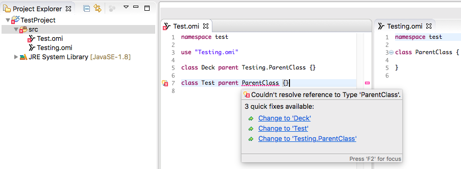

Re: Limiting cross-reference to a single file [message #1758943 is a reply to message #1758936] Tue, 04 April 2017 13:39 Go to previous messageGo to next message
Heres a quick picture of what I'm talking about:
index.php/fa/28971/0/
Where 'a' is a class in another file.
This is wrong because its acting as if its local, but its foreign. The error should be the other way around.
'C' is also foreign, but shown as local, and produces no errors. :/

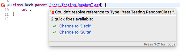

Hey, I tried what you said before and as I previously wrote I didn't know where to put that override which you've clarified so I was able to fix it. Smile
I've done as you say and it works! Thankyou! The file will now throw an error because it can't find the specified type within itself!
The issue is though, those string imports are giving me errors. I'm assuming this is the next step Confused
index.php/fa/28978/0/
Re: Limiting cross-reference to a single file [message #1759022 is a reply to message #1759021] Wed, 05 April 2017 07:39 Go to previous messageGo to next message
No,
you are still doing different things
the modell shall look like
use "platform:/resource/xxxxxx/random/folders/second_file.mydsl1"     // also a FQN
class ChildClass parent ParentClass {
or
class ChildClass parent second_file.ParentClass {
yours does not.
this works fine on my machine.
if this works on your machine as well we can do the second step
Re: Limiting cross-reference to a single file [message #1759024 is a reply to message #1759022] Wed, 05 April 2017 07:54 Go to previous messageGo to next message
Alright, here we go.
String encapsulation for import statement, normal qualified name for class.
Works beautifully. Thankyou very much.
