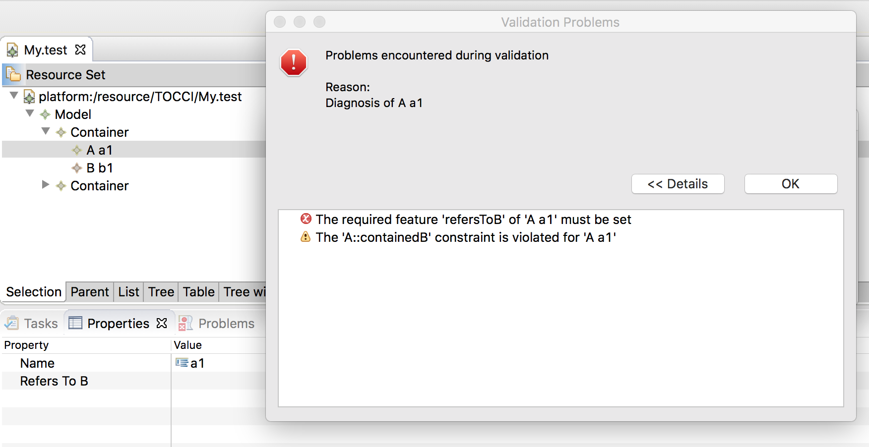

When refersToB reference is null, the OCL validator shows two validation problems (as shown in the image below):
- (error) The required feature 'refersToB' of 'A a1' must be set, because of refersToB : B[1] property
- (warning) The 'A::containedB' constraint is violated for 'A a1', because self.refersToB is null
My question is that how can I limit the validation of containedB to be done ONLY when self.refersToB is not null?

Re: limit OCL validation of an invariant [message #1758764 is a reply to message #1758761] Sun, 02 April 2017 08:08 Go to previous messageGo to next message
property refersToB : B[1];
asserts that refersToB cannot be null, so one of the code generator optimizations throws away the dead code path.
IMHO "X <> null" is better style than "not X.oclIsUndefined()".
You may find "implies" helpful for guards.
One day there might be an optimization that orders all constraints applicable to a particular object so that the simplest execute first and avoid degenerate repeated failures.
So for your case, the failure of the refersToB non-null constraint could inhibit further constraints that navigate from refersToB.
Ed Willink
