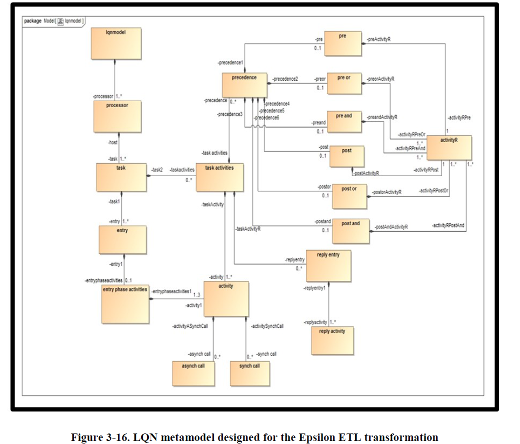

Re: problem with adding element to ordered set [message #1758716 is a reply to message #1758696] Fri, 31 March 2017 17:58 Go to previous messageGo to next message
index.php/fa/28951/0/index.php/fa/28950/0/index.php/fa/28950/0/Hi Dimitris ,
I have attached the metamodel as a diagram ,i hope it can help you .The relation between taskactivities and activity is very clear in the diagram.

Re: problem with adding element to ordered set [message #1758730 is a reply to message #1758716] Sat, 01 April 2017 03:27 Go to previous messageGo to next message
Hi Taghreed,
To add an "activity" "a" under a "taskactivities" "ta", "ta.activity.add(a);" should work.
