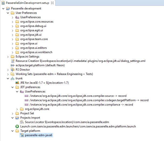

For the compiler level, I've used the preferences recorder to capture the switch to 1.7. I've tried to store that in 1 project-wide preferences section, and alternatively within the trunk stream (SVN lingo), as we'll probably evolve to having different java levels for different branches in the future. In both cases the level is not applied during the startup tasks, while the other prefs are correctly applied.
The setup model is in attach (just disabled the link to our SVN repo), and in this shot :

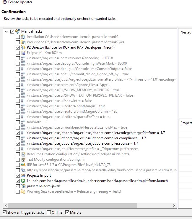

When looking at the triggered tasks in the started installation (Help > Perform setup tasks) it shows (I think) that the preferences were indeed not applied. I can then trigger that manually and it goes fine then.
index.php/fa/28918/0/
