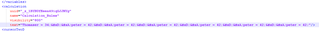

Re: EAttribute serialized as Element not attribute (override?) [message #1758570 is a reply to message #1758535] Thu, 30 March 2017 04:16 Go to previous messageGo to next message
Hi Ed
Thanks for your fast response
I tried with the second solution (XMLResource.OPTION_LINE_WIDTH, 10)
And yes that for sure do something with my savefile.
But not what I want, of how it looks with the second solution.
I attached a picture
But the text still gets very long.
Basically, you can say that everytime the output is
It means its represent a newline.
(not sure it is xtext syntax or EMF)
So best case would be that everytime a "
" comes it should also span over more lines.
