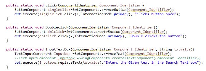

I am new to Jubula, and I want to test a RCP Application. I have successfully tested the RCP Application using Jubula Standalone Version 8.4.1.123.
I am able to store the value of the Button Component in a Variable the use it for further steps.

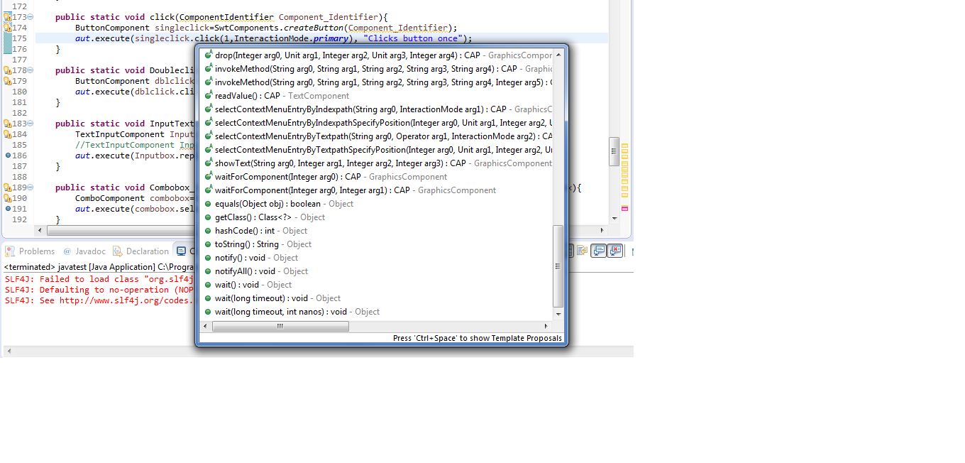

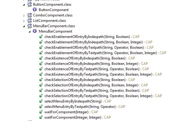

Now, I am trying to convert this to java code. I have imported all the jars in the api folder in the Jubula installation folder. I am able to make the button click, insert text and so on. But when I try to get the value of the button, I am unable to do it, since the store value property is missing in the component jar.
Can anyone help me out in this?
I have attached the Screen shot of my sample code.

All TextComponent and its subclasses have the method "readValue()" which is getting the text of the component. Also there are things like "getValueAtMousePosition" for Tables. For these the "Result" is important. See example below.
This is not a real store property, but you can save the text value wherever you want. Or in other words the handling or storing of theses values you must implement yourself.
--> this is an example for your InputTextBox method
Result result = aut.execute(Inputbox.readValue(), null);
System.out.println(result.getReturnValue()); // now you can do everything with the text value of the component.
