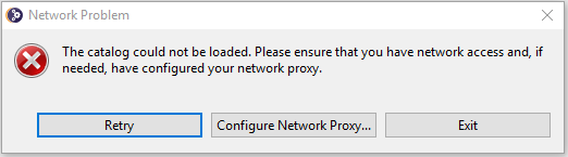

index.php/fa/28881/0/[/img]Hi, when ever I try to install eclipse neon, I get this error.
I've tried installing this many times before, always the same error. index.php/fa/28881/0/

Have you done the things prescribed there?

Yes, but I'm not using a proxy. None of it makes any sense, I just want it to connect to my internet so I can install it :/
Re: Can't install [message #1758389 is a reply to message #1758382] Tue, 28 March 2017 06:17 Go to previous messageGo to next message
Something is preventing the installer process from successfully downloading the setup archive:
http://www.eclipse.org/setups/setups.zip
This resource should be downloaded can cached in ~/.eclipse/org.eclipse.oomph.setup/cache/http___www.eclipse.org_setups_setups.zip. Does that folder have any contents for you. Is your firewall perhaps restricting/block network access for the installer process?

So you don't seem to have proper access to the internet. Even if you (somehow) load the setup archive, you can't read any of the p2 repositories either:
[2017-03-28 20:10:49] ERROR: org.eclipse.equinox.p2.transport.ecf code=1002 Unable to read repository at http://download.eclipse.org/technology/epp/packages/neon/content.xml.
java.net.SocketException: Permission denied: connect
I'm not sure what kind of environment you're in, but it looks like a network problem. Mostly a firewall blocking the network or being behind a proxy with restricted access. Have you tried turning your firewall off (for testing)?
