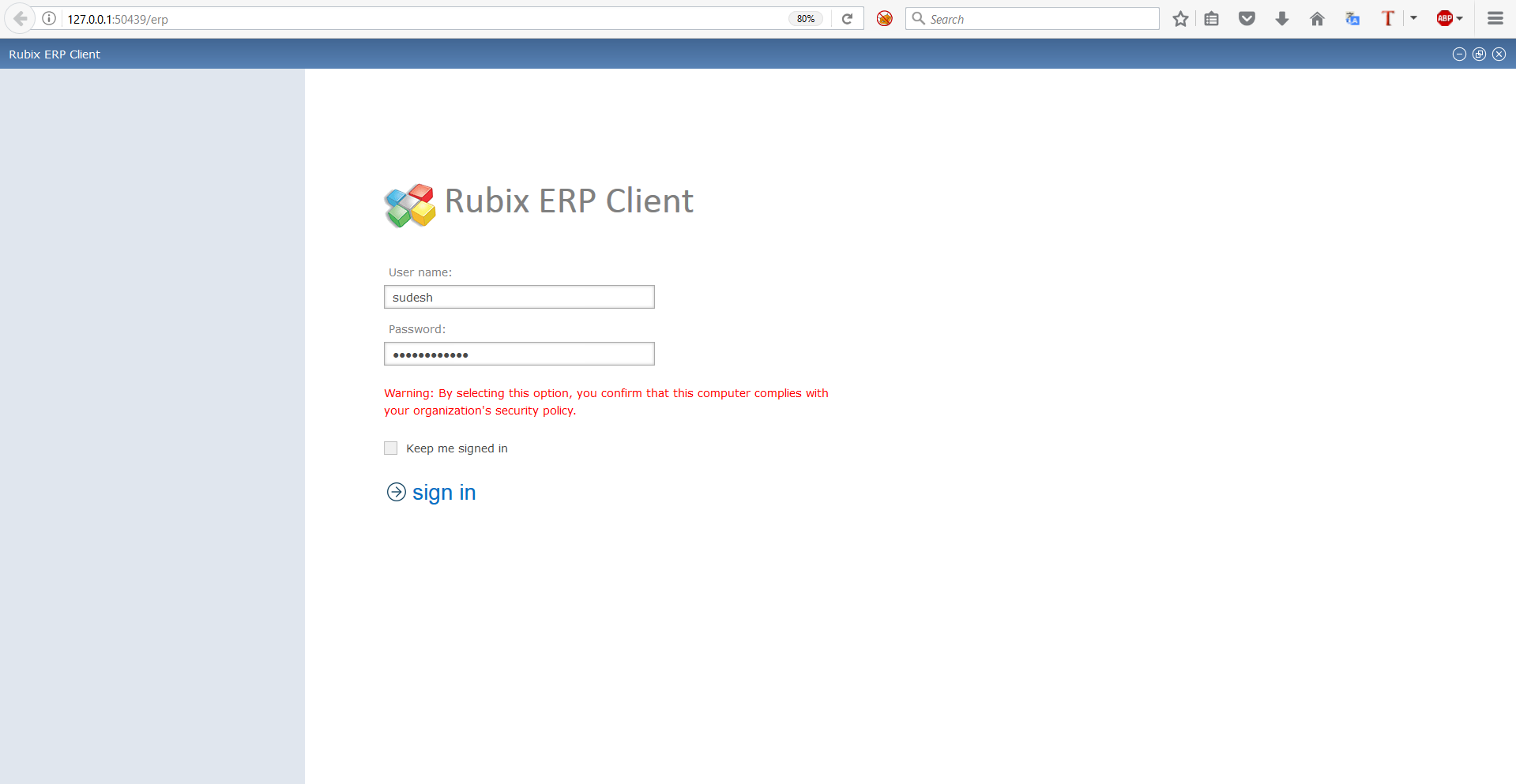

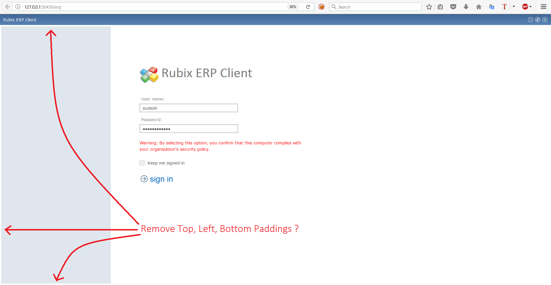

We use theme contribution to extend the existing RAP default theme. We have 2 perspectives to implement the login and it works well. By default when start, the login perspective is loaded, and when the user/pass credentials are processed and valid, we unload the login perspective and load the client perspective, where application module constructs are placed.
We are required to remove the padding from left panel. please find the attachment.
(the space between top, left and bottom should be removed, and this should be ok, as we don't place other views editor in login perspective).
Any idea ?
Sudesh

Re: How to remove padding value from perspective's page layout [message #1758298 is a reply to message #1758247] Mon, 27 March 2017 07:24 Go to previous messageGo to next message
If, for example, the left part of your view is a Composite, and if you have a theming css file somewhere, you can try this:
In your css file:
Composite.KeyStringOfYourChoice
padding: 0px 0px 0px 0px;
In your java file:
final Composite yourComposite = new Composite(composite, SWT.NONE);
yourComposite.setData(RWT.CUSTOM_VARIANT, "KeyStringOfYourChoice");
This will work fine for all controls whose padding values can be controlled via CSS. An excellent page for finding this out would be http://download.eclipse.org/rt/rap/doc/3.0/guide/reference/theming/index.html
Re: How to remove padding value from perspective's page layout [message #1758460 is a reply to message #1758298] Tue, 28 March 2017 18:41 Go to previous messageGo to next message
let me try and keep you posted !
Re: How to remove padding value from perspective's page layout [message #1758463 is a reply to message #1758460] Tue, 28 March 2017 19:09 Go to previous messageGo to next message
I wouldn't think a theme padding value would impact the padding of a Composite. It would be a Layout creating the gap when it lays out it's child controls
Re: How to remove padding value from perspective's page layout [message #1759120 is a reply to message #1758463] Thu, 06 April 2017 11:28 Go to previous messageGo to next message
Correct, composite padding didn't help here. Any idea how to fix this or workaround ?
Re: How to remove padding value from perspective's page layout [message #1759148 is a reply to message #1759120] Thu, 06 April 2017 20:08 Go to previous message
You'll need to walk through the widget tree, find the correct composite and update the values of its layout manager.
