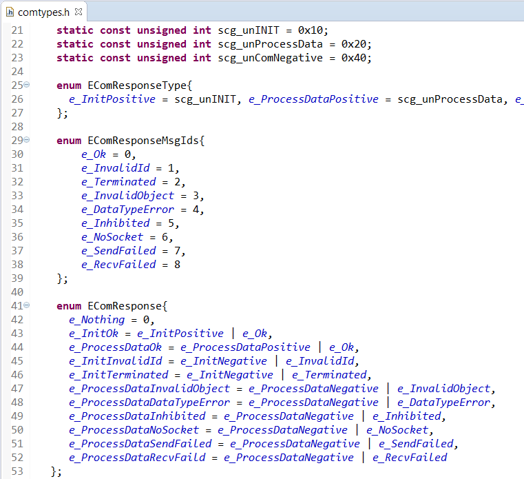

The code scheme being returned by the communication architecture (shown in the image) is using some return codes for multiple purposes that do not allow to differenciate them. For example, SERVERS are getting an e_InitTerminated both when they are asked to be shutdown by a INIT- and when a client gets disconnected.
comtypes.h (lines 21-53)
Right now the bits of the return code are:
  1. Error code
  2. Error code
  3. Error code
  4. Error code
  5. Flag for INIT return codes
  6. Flag for non-INIT return codes
  7. Flag for unsuccessful operation
  8. Unused
8 error codes require 4 bits, then 2 flags are being used for opposite states that would only require one (using two makes checking them a bit easier as you can use two different masks instead of just one and negating the result) and a flag for unsuccessful responses which that can also be matched negating e_Ok as every other code is an error.
These 3 enums and their members appear 957 times (702 e_ProcessDataOk is the most repeated one) in the whole project (including tests) unless there is some variable name overlapping, so before changing all of them and submitting a merge request I would love to hear feedback.
My proposed scheme would be the following:
  1. Error code
  2. Error code
  3. Error code
  4. Error code
  5. Reserved
  6. Reserved
  7. Event code
  8. Event code
The reserved bits are available if some additional error or event codes want to be introduced. The highest 2 bits (event code) determine which event the return code belongs to:
  • 0 (00): INITO
  • 1 (01): CNF
  • 2 (10): IND
  • 3 (11): -
Despite the current error codes can be mapped to just 3 bits by overlapping codes that can't happen under the same event codes such as Invalid ID and Invalid Object, I've decided against this approach as checking if an error code is of some kind may give false positives or require event matching too.
  • 0 (0000): Nothing (INITO, CNF, IND)
  • 1 (0001): Ok (INITO, CNF, IND)
  • 2 (0010): Invalid ID (INITO)
  • 3 (0011): Terminated (INITO)
  • 4 (0100): Invalid Object (CNF, IND)
  • 5 (0101): Data type error (CNF, IND)
  • 6 (0110): Inhibited (CNF)
  • 7 (0111): No socket (CNF)
  • 8 (1000): Overflow (CNF, IND)
  • 9 (1001): Underflow (CNF, IND)
  • 10-15 (1010-1111): -
This scheme makes possible to differenciate both the code and the event separately. It has been designed with scalability in mind in case some new error or event codes want to be introduced. For this purpose a constant has been set to determine how many bits are used for event codes even if this number will probably not increase. Operators & overloading allow for easy event or error code checking and I'm currently implementing operators for code assigning (|= and &=, the first will only assign the new code if the previous is e_Nothing or e_Ok while the second one will always update the error code), and other common operations like conversion between the 3 enum types and so on. I implemented a demo of how this works in repl.it.

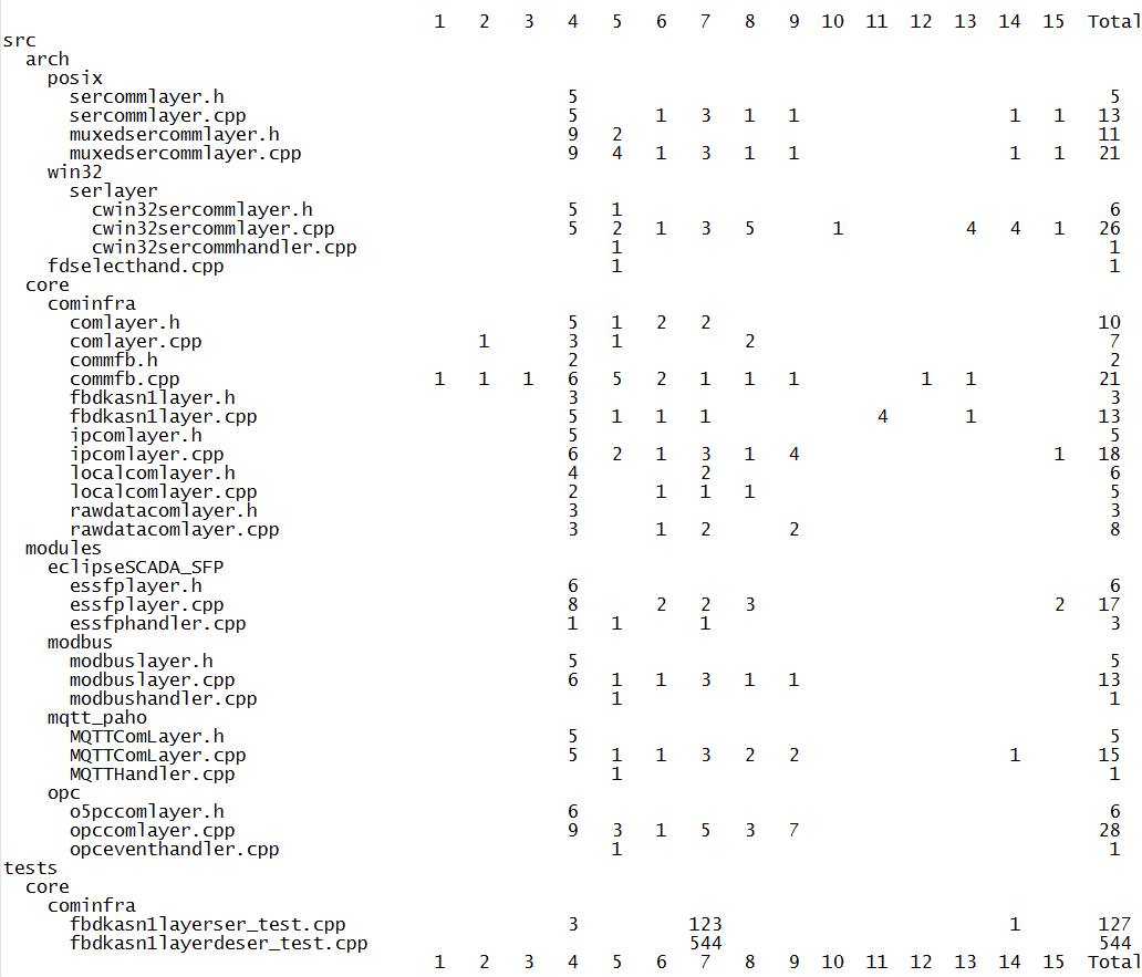

Either way, the following variable appearances (957 in total) should be changed:
  1. scg_unInit (1)
  2. scg_unComNegative (2)
  3. e_Terminated (1)
  4. EComResponse (139)
  5. e_Nothing (30)
  6. e_InitOk (16)
  7. e_ProcessDataOk (702)
  8. e_InitInvalidId (21)
  9. e_InitTerminated (19)
  10. e_ProcessDataInvalidObject (1)
  11. e_ProcessDataDataTypeError (4)
  12. e_ProcessDataInhibited (1)
  13. e_ProcessDataNoSocket (6)
  14. e_ProcessDataSendFailed (8)
  15. e_ProcessDataRecvFaild (6)
From this 957 appearances, 671 are in 2 test files as can be seen in this image:
index.php/fa/28851/0/
[Updated on: Thu, 23 March 2017 11:12] by Moderator

Re: Communication return codes enhancement proposal [message #1758171 is a reply to message #1758116] Fri, 24 March 2017 05:13 Go to previous messageGo to next message
Alois Zoitl wrote on Thu, 23 March 2017 16:52
Didn't expect taht we use the exisiting infrastrukture in so many places.
At least 70% are in test files, and they should be as easy as swapping them for their new version.

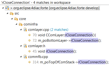

Adrian Orive wrote on Tue, 28 March 2017 07:08
Alois Zoitl wrote on Mon, 27 March 2017 13:17
I some got the idea if we should move the layer creation and deletion process completly to the comfb. so the rCloseConnection wouldn't be needed. But I'm not sure if this is a good idea. What do you think?
I actually like the way it works now, as each layer is double-linked to the following and previous layers aside from the FB. This could also be done after creating all the layers but I think the actual way is more natural. The other way round could also be done probably and would allow to keep a reference to not only the top most layer at the FB but also the bottom most one, what will probably mean that the queue of interrupts could be simplified but this method will probably require some aditional auxiliar methods to properly double-link every layer (getters and setter for bottom and top layers), so the complexity will move to another part.
The reson I suggested to move rClose code into ComFB is that then a layer does not need to know anything about shutdown or initilization orders. Also there is some code duplication in the closeConnection and createConnection code in the comFB and the according code in the layer. A noticed this when you had to change the rClose code on both sides. With a moveing everything to one place this could be omitted. But not sure if it is worth the effort.
For new code please follow the new codeing rules. I know this leads to some mixed code but ove time I think it will harmonize more and more.
Also it would be good if you could set your IDE to replace tabs with spaces and set the tab with to 2.
Re: Communication return codes enhancement proposal [message #1758391 is a reply to message #1758380] Tue, 28 March 2017 06:57 Go to previous messageGo to next message
Alois Zoitl wrote on Tue, 28 March 2017 08:27
Thanks for the new push. I just reviewed and successfully merged it.
From your name proposals I like disconnect the most. I think we can go without.
disconnect sounds fine. It appears 4 times in the whole project as shown in the image:
rCloseConnection() appearances
I have the commit ready but can't push it because the Change 93960 is closed.
