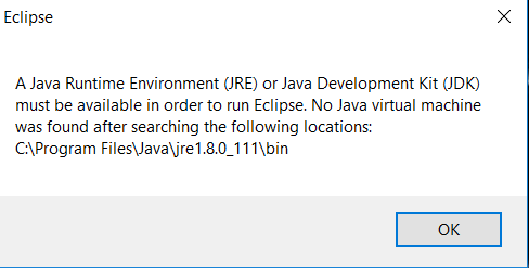

So, I can't get Eclipse Neon to work for me, all it's telling me is shown in the picture included. If you can help, I would appreciate it. I have the necessary java version it wants on my computer, it's just not registering that its there.

If you're using a 32-bit Eclipse, it might be that you've updated to a 64-bit JRE. Exactly what Eclipse download file did you start with?
Re: Eclipse won't work after a few months of not using it [message #1758098 is a reply to message #1758048] Thu, 23 March 2017 10:05 Go to previous messageGo to next message
Eclipse Neon 64 bit.
Re: Eclipse won't work after a few months of not using it [message #1758214 is a reply to message #1758098] Fri, 24 March 2017 13:57 Go to previous message
See this, especially the first part about eclipse.ini
