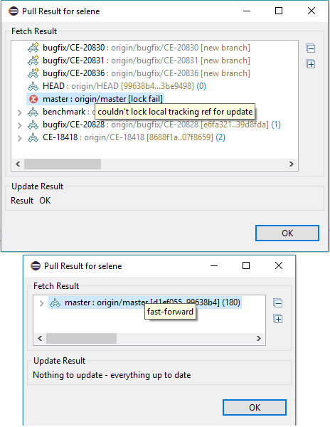

I mean it says [lock fail] after the origin/master branch name instead of the commit sha/count in the pull results dialog (like https://wiki.eclipse.org/File:Egit-3.1-FetchWizardResult.png except after pull rebase, not a fetch).
I'll add a screenshot next time it happens (typically if I have a local commit and pull a one or more remote commits).

Here are the screenshots:
index.php/fa/28850/0/
-I just made a local commit (one commit ahead of master)
-team -> pull... -> rebase
Shows first dialog with the [lock fail] for the master branch
-now show repository 181 commits ahead of master (which is how far the remote master is ahead of the the remote head)
Show the second dialog: local master fast-forwarded 180 commits, so now correctly only 1 commit ahead
I'm new to Git, but is EGit incorrectly pulling (rebasing) my local head with the remote HEAD? And because HEAD is just a pointer to local master it tries to rebase it both the the origin/HEAD and origin/master (which do not point to the same commit), which leads to the conflict.
