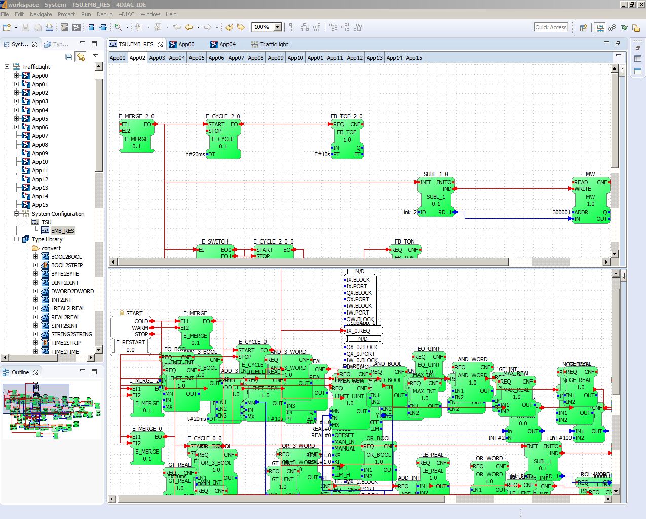

I want to suggest new way to edit EMB_RES with use of layers without many Map\Unmap actions.
For example, we have system with many apps and FBs from these apps mapped to one EMB_RES.
index.php/fa/28817/0/
It turns out that it's very difficult to work with FBs from all apps in one window.
I suggest to use of layers when every app will be a layer.

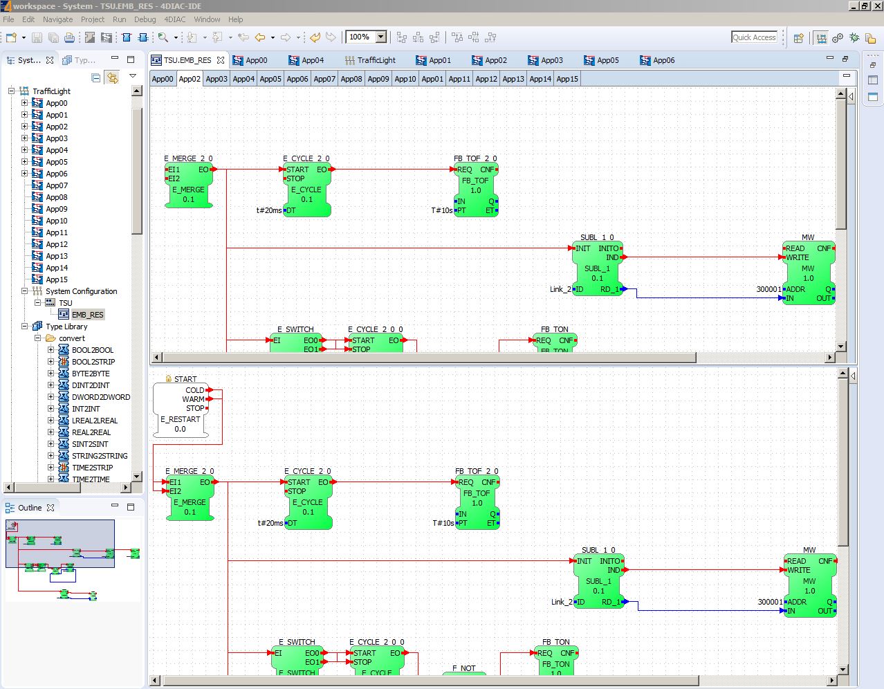

For example if I want to view FBs from only one app I activate only one layer.
index.php/fa/28818/0/

Thank you for this suggestion. It sounds very interesting. For 1.9.0 we have done a first cleanup of the resource editor and removed the the top application part as a whole as for big applications the mapping is easier and more efficient to map via the context menu. But showing only application parts in resources is an interesting addition.
I think in your setup haveing more resources could be an interesting option. Have you tried that. Furthermore I think the new subapplication model will be good for you.
One final issue i have with your overlay, if I want to connect two application sthis will not work which I would find a shortcomming.
I suggest to use of layers when every app will be a layer. And I will be able to activate any of the layers in any combination (any one, any two or every layers).
Good point. As said in my post i like your suggestion. But not sure that we'll be able to already consider it for 1.9.0 but an improved resource editor is definitly on our midterm roadmap.
