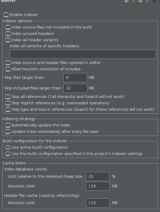

You could try modifying the Indexer options.
I'm thinking the Indexing strategy and Cache limits
I believe these are the defaults;
index.php/fa/28791/0/
HTH
