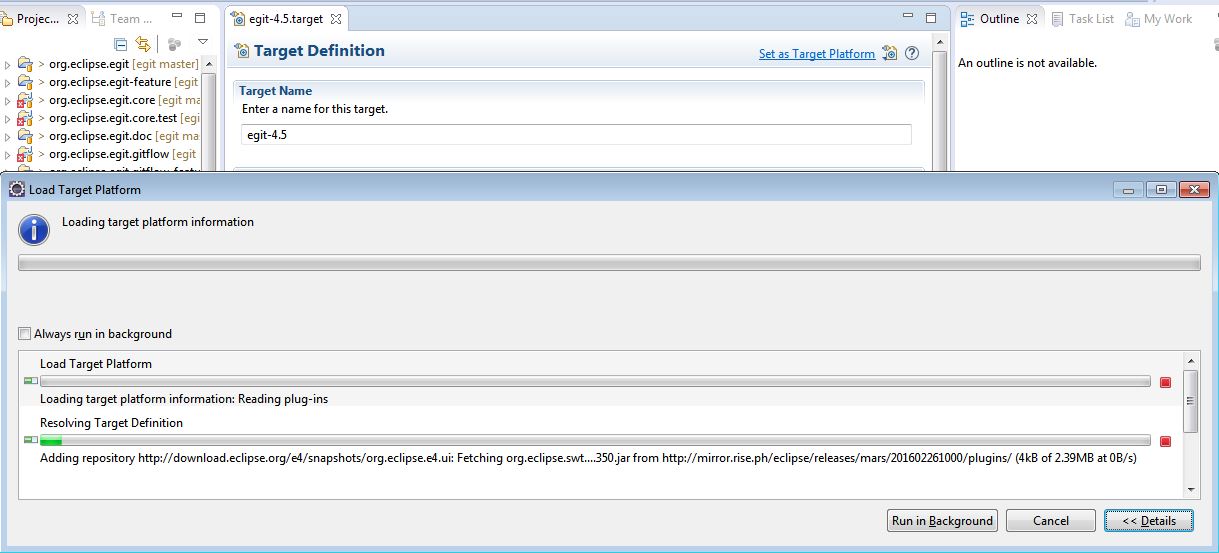

HI,
I have to build the EGit Source code. I followed the steps specified in EGit Contributor Gudie - http://help.eclipse.org/neon/index.jsp?topic=%2Forg.eclipse.egit.doc%2Fhelp%2FEGit%2FContributor_Guide%2FContributor-Guide.html
I have used Eclipse Mars, JDK 8 and Maven 3.3 for building.
I have downloaded both JGit and EGit from clone and imported into same workspace.
Followed the below steps:
1. Open File > Import... and select Git > Projects from Git
Select URI
2. Enter the URLS below:
EGit URL - https://git.eclipse.org/r/egit/egit.git
JGit URL - https://git.eclipse.org/r/jgit/jgit.git
3. Selected 'master' branch
4. Import existing projects into the workspace from the newly created working directory.
5. After importing the projects to workspace, to resolve the build errors, I followed the steps specified in section "Development IDE Configuration".
6. Followed Option 1 (recommended): Use a Target Platform to add dependencies
7. Open the org.eclipse.egit.target project and selected egit-4.5.target for Eclispe Mars. In the editor, selected the "Set as Target Platform" link.
8. It open the popup "Load as Target Platform" and it is not closed even after 1 hour.
Let me know if you need any error logs to get more details about the issue.
Can you provide me all the steps required to build EGit project in Eclipse Mars.
I have attached the snapshot of "Load as Target Platform" Popup, to give some more context into this issue.
The progress bar shows 0% even after 1 hour.
