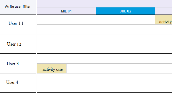

I'm sorry, I have not explained correctly, I illustrate the problem with an image.
In the cell with the text "write user filter" you have to enter the user name that you want to filter.
Example: If you type User 1 then only the User 11 and User 12 rows will be displayed.
Alternatively you could implement a filter from the outside. If you use the FilterList you can set filters via some text field that is not included in the NatTable and set the filter to the FilterList this way. Then no filter row integration in NatTable is needed.
I think it's a good alternative
