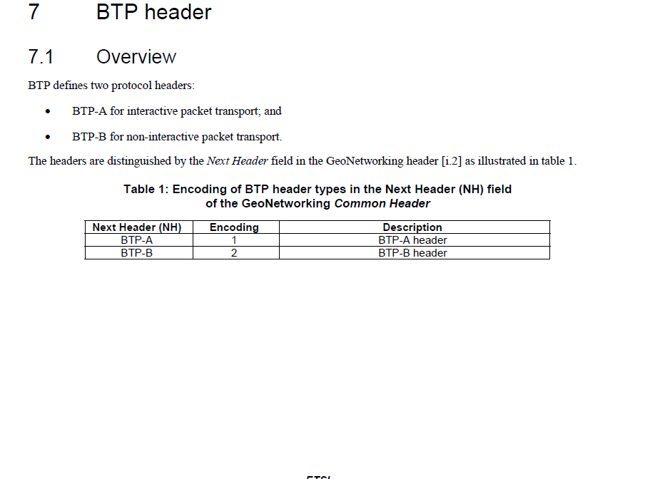

Hi Yann,
according to :
ETSI TS 102 636-5-1 V1.1.1 (2011-02)
Technical Specification
Intelligent Transport Systems (ITS);
Vehicular Communications;
GeoNetworking;
Part 5: Transport Protocols;
Sub-part 1: Basic Transport Protocol
index.php/fa/28598/0/
Lenard will give you details about encoding/decoding BTP.
Best regards
Elemer
  • Attachment: BTP.png
    (Size: 28.41KB, Downloaded 520 times)

As stated in ETSI EN 302 636-5-1 V1.2.1 (BTP protocol description) the BTP header type can be identified by the NextHeader field in the CommonHeader in the GN headers, which always precedes a BTP header.
