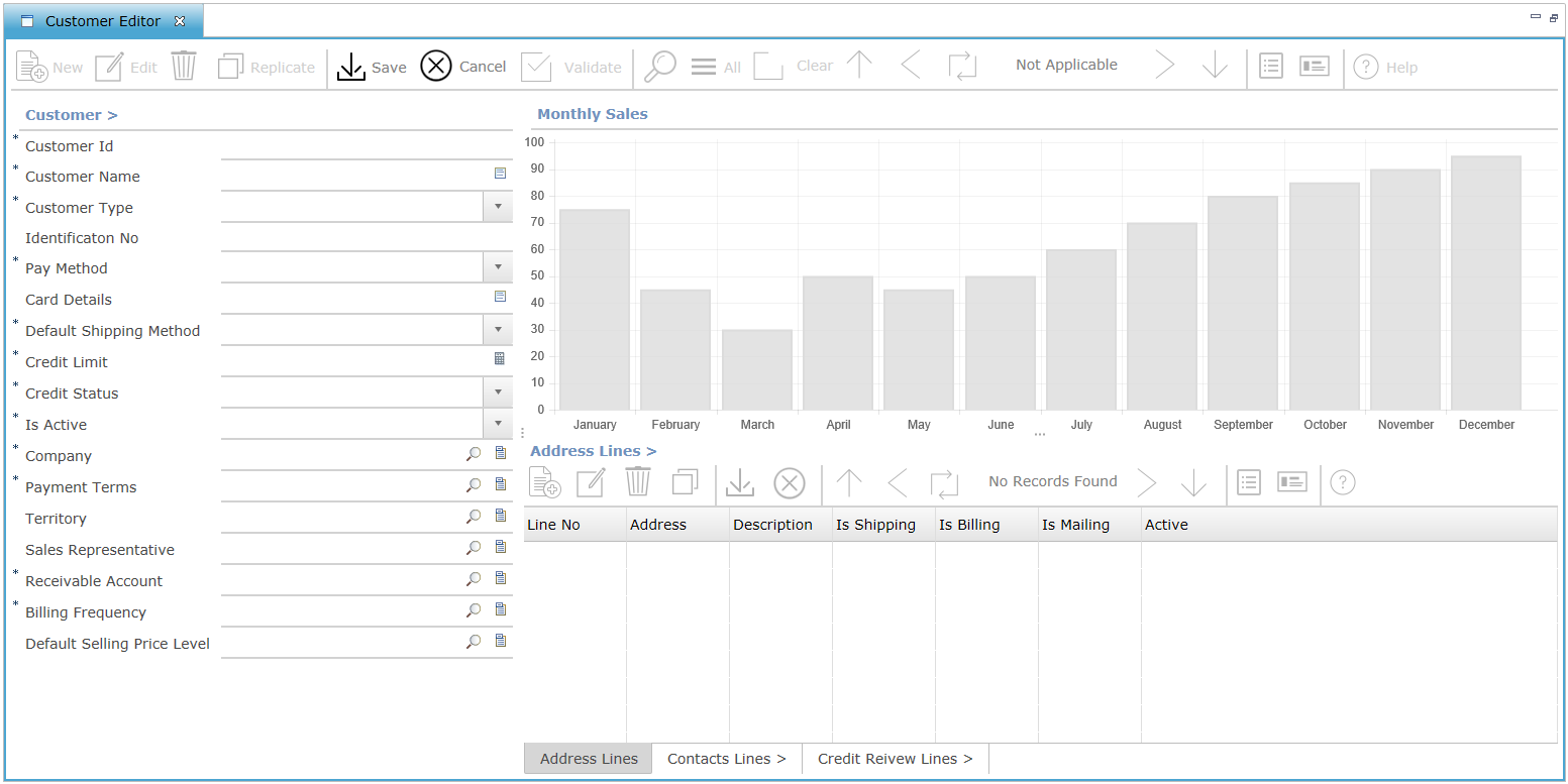

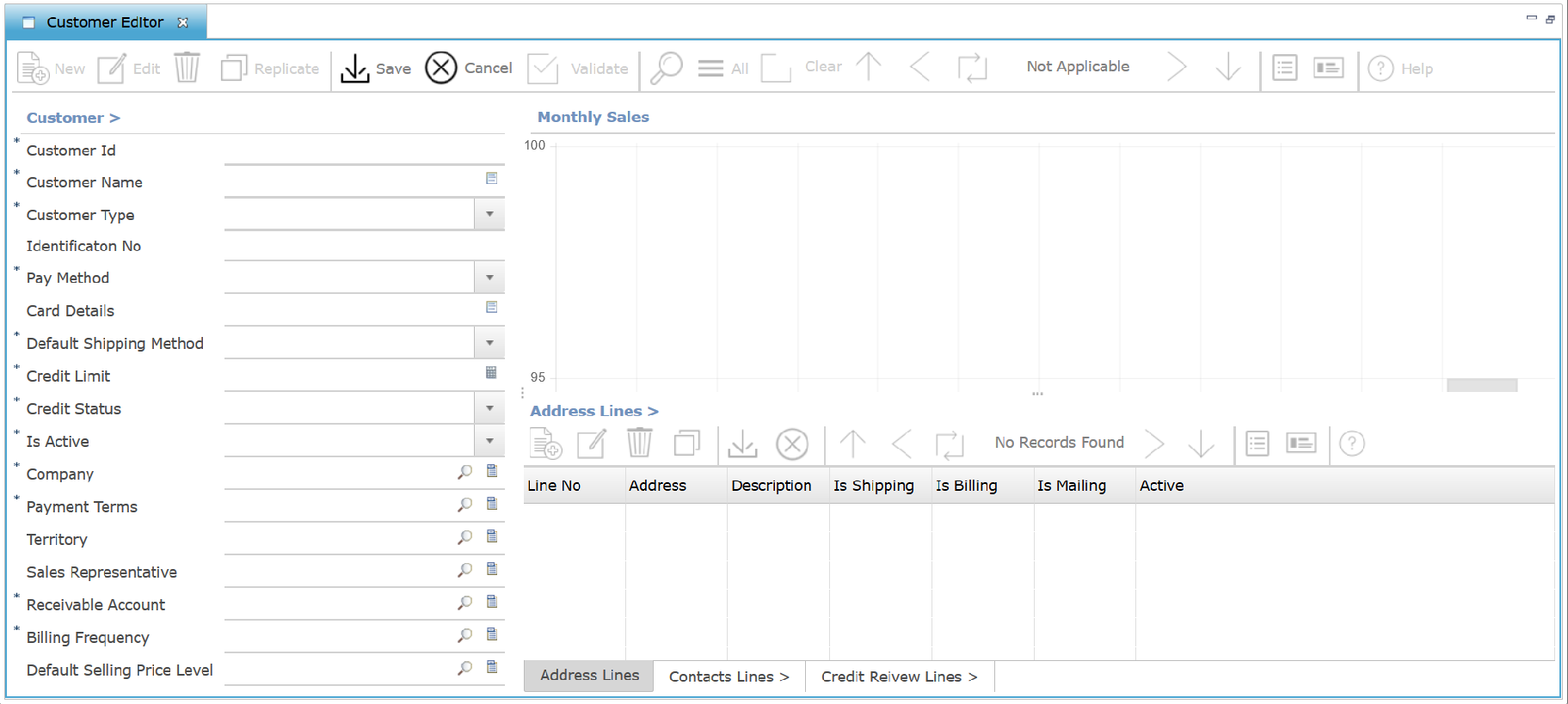

I have followed the tutorial eclipsesource by Tim Buschtöns, on integrating chartjs with eclipse RAP. It works out of the box when run with RAP internal web browser. However if you run the same using RAP External Web Browser, the chart is distorted and and when resize, values are getting decreased, diminished and you don't see the x axis labels, etc.
EclipseSource Tutorial > http://eclipsesource.com/blogs/2014/07/21/yet-another-charting-widget-for-rap/
Outcome >
Any idea, why the chart renders different on internal/external web browsers ?

did you change browser zoom level?
Ivan
Re: eclipse RAP + chartjs [message #1755083 is a reply to message #1755024] Mon, 27 February 2017 17:09 Go to previous message
Hi Ivan,

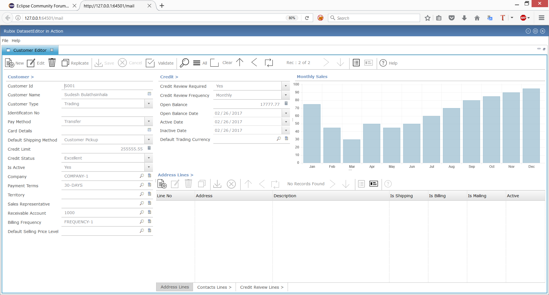

Finally it's working after adjusting the zoom level to a smaller size.
Now both RCP and RAP charts are in sync. Single source Rocks !

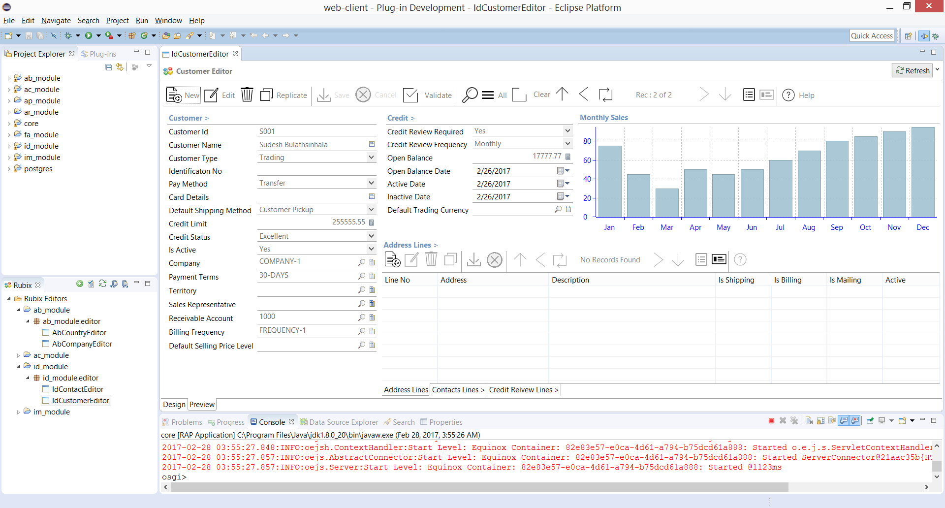

Thanks for your valuable suggestion.
