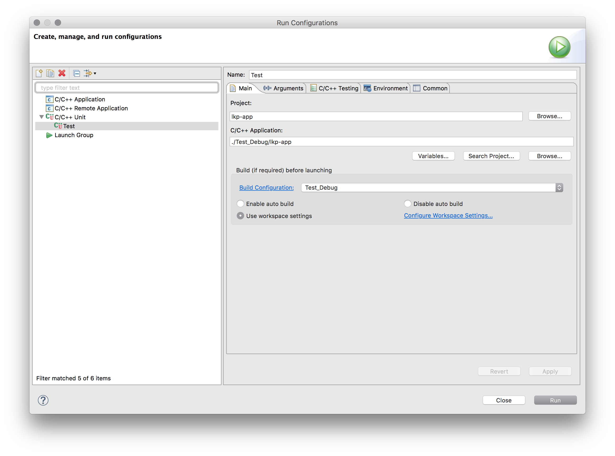

Hi all,
There are a few posts on this subject but I couldn't find any that matched my scenario. Apologies if this has been answered elsewhere.
I set up a C/C++ Unit Run Configuration, with my application set in the 'C/C++ Application' field as per the screenshot.
I then hit 'Run' and it successfully runs my application.
I then make a change to the application and re-build it. The build completes successfully and the new binary is in the same location as the previous one.
I hit the 'Run' button again and I get the error message: 'Launch failed. Binary not found'.
If I open the Run Configuration and hit 'Run' again without changing any of the settings, it successfully runs my application.
I can then hit the 'Run' button any number of times it will successfully run my application until I make a change and rebuild it. After rebuilding I get the error message again.
Does anyone have any idea on how to fix this?

Because the configuration is under C/C++ Unit Test and not C/C++ (local) Application.
The Run --> Run command (or Run button) is trying to find the configuration under Application.
http://help.eclipse.org/neon/topic/org.eclipse.cdt.doc.user/tasks/cdt_o_run.htm?cp=8_3_5
http://help.eclipse.org/neon/topic/org.eclipse.cdt.doc.user/tasks/cdt_t_run_main.htm
You probably want Run As

Thanks very much!
