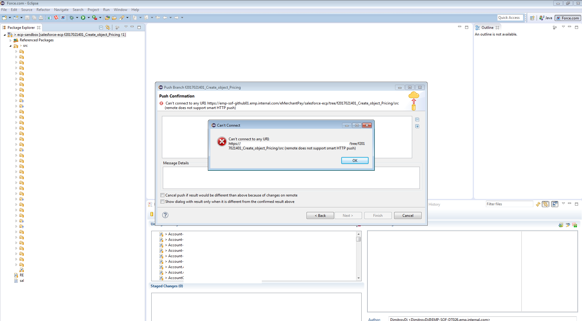

I'd like you to advise me how to push my code into git successfully.
Everytime I try to push I receive the following error message:
"Can't connect to any URI: (Remote does not support smart HTTP push)"

Can you push with native git from exactly that repository?
Re: Smart HTTP push error [message #1755273 is a reply to message #1755032] Wed, 01 March 2017 16:55 Go to previous message
this means the upstream git server you are trying to push to does not support smart HTTP (git) protocol
see https://git-scm.com/blog/2010/03/04/smart-http.html
