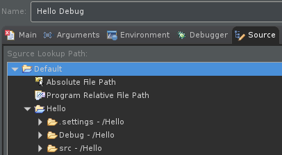

If you have no source available when you try debugging then the source tab may not been configured properly. Select the configuration as a Debug configuration; select the Source tab; and ensure the paths are correct. The default should be:
index.php/fa/28527/0/
