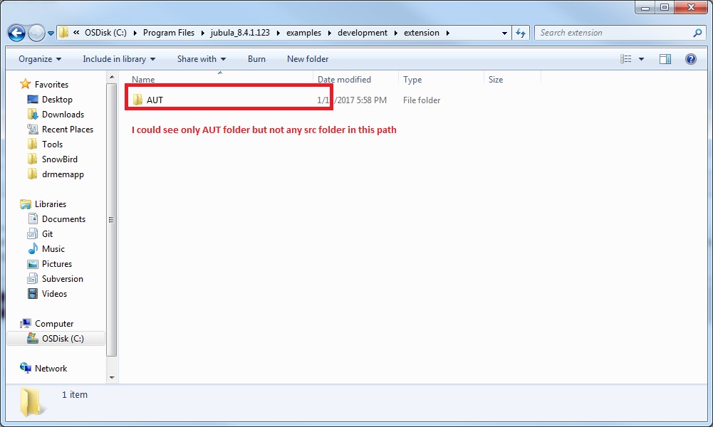

As suggested by you "- create an extension for your menu bars - information on creating extensions is available in the developer manual" I tried but got stuck with a problem.
After going through the developer manual, I have installed org.eclipse.jubula.repo.zip and was trying to import the existing piechart project to ITE but was unable to do so, since I didn't find source files under the path examples/development/extension please find the attached screen shot. Could you please help out on how to get the files and import the example project to ITE, what am I missing?

Re: JavaFx - Accessing MenuBar present inside tab of tabpane [message #1757852 is a reply to message #1756454] Mon, 20 March 2017 12:58 Go to previous messageGo to next message
Hi OM,
after installing the features from the org.eclipse.jubula.repo.zip the extension should be active in the ITE. If you'd like to have a look at the Source-Code of the extension, you would have to import these into an Eclipse IDE (and not into the ITE!). Our documentation says that there are examples in the org.eclipse.jubula.repo.zip but I just noticed that this is not true. However, you can find the example projects in our git-repository. The JavaFX extension consists of four packages:
- http://git.eclipse.org/c/jubula/org.eclipse.jubula.core.git/tree/org.eclipse.jubula.examples.extension.javafx.feature
- http://git.eclipse.org/c/jubula/org.eclipse.jubula.core.git/tree/org.eclipse.jubula.examples.extension.javafx.rc.container
- http://git.eclipse.org/c/jubula/org.eclipse.jubula.core.git/tree/org.eclipse.jubula.examples.extension.javafx.toolkit
If you would like to create your own extension, I would strongly recommend using the Jubula Extension Wizard for the Eclipse IDE. This wizard generates the basic structure for your extension and does also most of the configuration for you. More info about this can be found in our documentation [1].
Kevin
[1] http://testing.bredex.de/files/content/software/documentation/developerManual/extensionWizard/ch05.html​

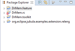

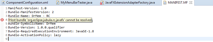

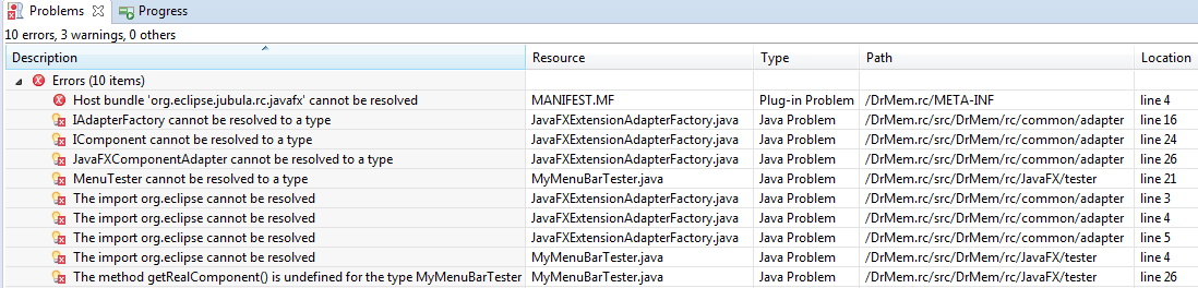

I have tried it using Eclipse IDE only.
I have created a Jubula Extension Project as in attached screen shot jubual_proj_files.jpg
Facing following errors as attached in screen shot Jubula_error1,2&3.jpg.
Could you please help me resolving this issue.

Re: JavaFx - Accessing MenuBar present inside tab of tabpane [message #1757887 is a reply to message #1757886] Tue, 21 March 2017 06:21 Go to previous messageGo to next message
Hi OM,
you have to set the target platform file to resolve the dependencies. Go into the org.eclipse.jubula.examples.extension.releng project and open the extension.target file from the targetDefinition folder. In the opened window, click on "Set as Target Platform" in the top right corner.
Kevin

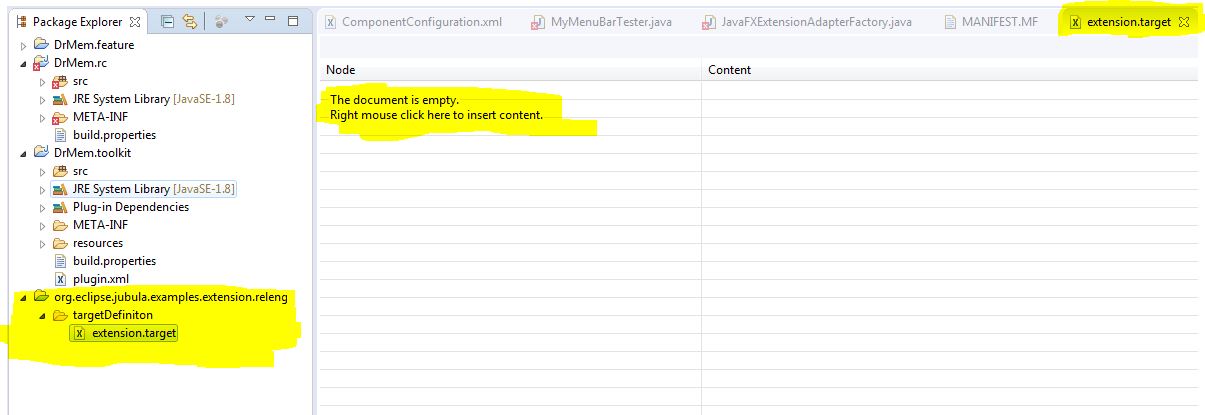

Re: JavaFx - Accessing MenuBar present inside tab of tabpane [message #1757962 is a reply to message #1757887] Wed, 22 March 2017 06:50 Go to previous messageGo to next message
Hi Kevin,
I am unable to do the step as suggested by you. I am not getting the option "Set as Target Platform", please verify the attached screenshot [Jubula_Error.jpg].
[Updated on: Wed, 22 March 2017 06:56] by Moderator
Re: JavaFx - Accessing MenuBar present inside tab of tabpane [message #1757965 is a reply to message #1757962] Wed, 22 March 2017 06:57 Go to previous messageGo to next message
When I perform right click nothing happens.
Re: JavaFx - Accessing MenuBar present inside tab of tabpane [message #1758057 is a reply to message #1757965] Thu, 23 March 2017 04:27 Go to previous message
Hi OM,
it seems like the target platform editor is not installed in your IDE. Go to Window > Preferences > Plug-In Development > Target Platform. You will then see a list where the target platform file should already be present. Simply enable the file by ticking the according box and hit Apply. The target platform should then be resolved.
Kevin
