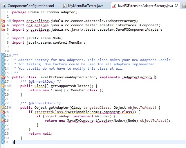

Hi Alex,
Thanks for your support.
As suggested by you "- create an extension for your menu bars - information on creating extensions is available in the developer manual" I tried but got stuck with a problem.
After going through the developer manual, I have installed org.eclipse.jubula.repo.zip and was trying to import the existing piechart project to ITE but was unable to do so, since I didn't find source files under the path examples/development/extension please find the attached screen shot. Could you please help out on how to get the files and import the example project to ITE, what am I missing?
