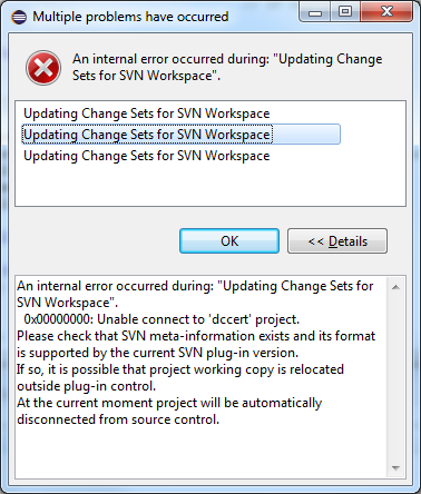

I'm testing Neon and the new Subversive version's interaction with existing workspace projects prior to migrating my team's IDE installations, and have run into an increasingly curious issue that did not take place on the old Mars.1 with Subversive 3.0.2 using Native JavaHL 1.8.1 install.
After committing a somewhat extensive set of changes (lots of edits, several file deletions) with a nice, long, descriptive log comment, I was greeted with this frightful looking thing:
index.php/fa/28483/0/
However, upon checking with Tortoise, I found my changes had gone in just fine, though I could no longer get the project to interact with the repo in Eclipse. This being a project made with a previous version, and no code changes outstanding, I just torched the whole project on disk and checked out my new revision.
Then today, I made a similar commit (lots of edits, a file name change) in the same, now version-matching project, and had the issue recur. Perplexed, I checked the log and found all this:

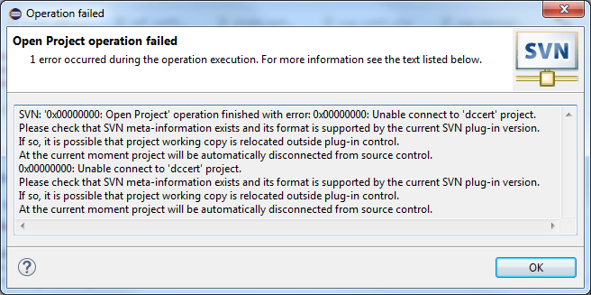

Update to this tomfoolery: a possible culprit was identified in the presence of a very old project description file from some version of Zend Studio, which called for a module I don't have, and had a project name not matching the actual project name. This was dealt with, and the svn-ignore property updated to stop committing .project and .buildpath.
The resulting commit edited 3 files, removed one, and changed the properties on each of the directories. Vexingly, the issue promptly manifested. Thrice.
index.php/fa/28589/0/
The log showed the same cascading error pile as before, but to be more thorough than last time, I've attached the whole thing starting from the first event to the logger giving up out of enui and saying "... 9 more".
EDIT: that...was actually the wrong image. Updated with the correct one, rather than just the same one from upthread due to a misclick.
