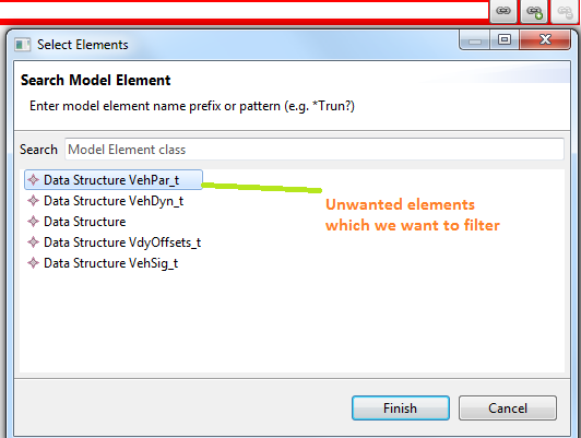

We want to change the objects that are being displayed in the reference dialog. We have extended ECPReferenceService and attached it to "org.eclipse.emf.ecp.view.context.viewServices" extension point. We have set priority lesser than zero , but the new class's addExistingModelElements method is not getting called.
We want to know as even after setting priority lesser than zero our custom class is not getting called. Do we have to register new class at some other places.
