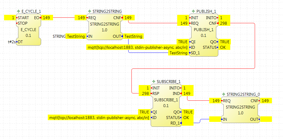

I'm testing mqtt in forte running under Linux.
The subscriber does not receive the correct string. External paho or mosquitto subscriber are also receiving this string.
Please have a look a my attached 4diac screen shot.
index.php/fa/28441/0/
Re: mqtt [message #1754127 is a reply to message #1754123] Tue, 14 February 2017 11:05 Go to previous messageGo to next message
Try adding "raw[]." before the mqtt ID like:
raw[].mqtt[tcp://localhost....
See:
https://www.eclipse.org/forums/index.php/t/1074332/
Also, you don't need to connect an event to the RSP of the subscriber. When a packet arrives, the IND will trigger an event.
Re: mqtt [message #1754289 is a reply to message #1754127] Thu, 16 February 2017 03:30 Go to previous messageGo to next message
it works.

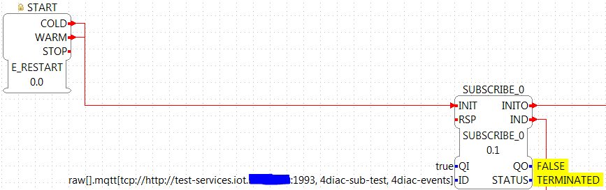

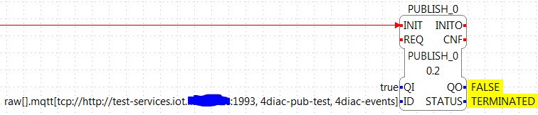

I will ask here to keep the forum tidy, but if you think this should be a separate post, split it or let me know so I can do it myself.
I was trying to communicate over MQTT (for that, I compiled Paho MQTT C library and added the following command line arguments to cmake in the setup_posix.sh: -DFORTE_MODULE_SysFs=ON -DFORTE_COM_PAHOMQTT=ON -DFORTE_COM_PAHOMQTT_DIR="../../../paho.mqtt.c") and added a publisher and subscriber FBs as shown in the images:
Publisher
Subscriber
EDIT: The http:// should not be there and the port should be 1883. These are just typos when restoring to the first version after the tests I carried out and they are not the source of the problem.

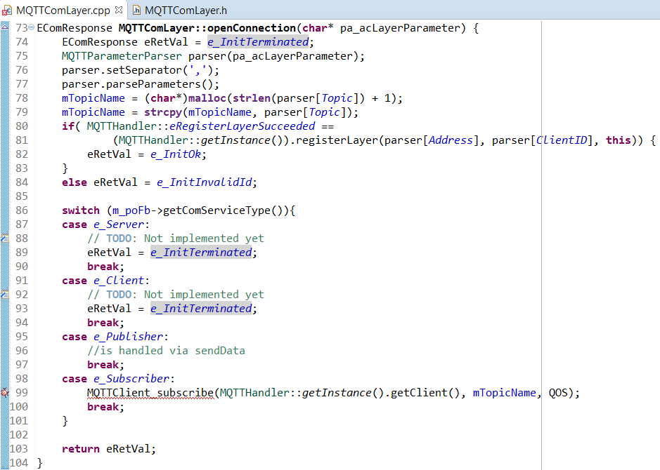

And the only difference is that I'm getting a INVALID_ID message instead of TERMINATED in both cases.
MQTTComLayer.cpp only has 3 posible spots for TERMINATED, messages as shown in the next image: the first one is overwritten before returning, and the second and third ones are for MQTT clients and servers which are not implemented. INVALID_ID is just present once and can also be seen in the image.
MQTTComLayer.cpp (lines 73-104)
My guess is that the error comes from a lower layer, so I will inspect raw and fbdk layers now but if you guys have any idea about what could be the cause please let me know.

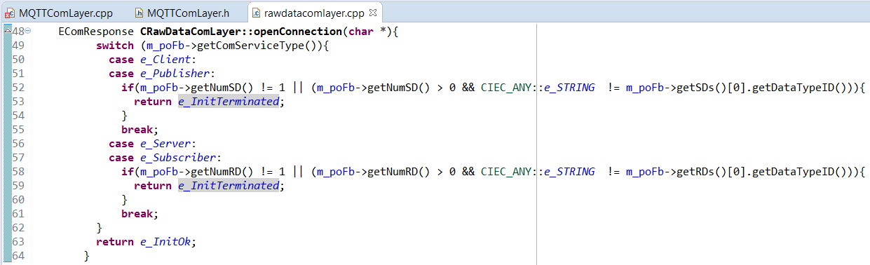

UPDATE: I only found TERMINATED in rawdatacomlayer.cpp as seen in the following image.
rawdatacomlayer.cpp (lines 48-64)
Correct me if I'm mistaken, but I think raw only works for publishers with at least one data input, so this means that fbdk should be my option. This also tells me that the ID I showed in the first 2 images must have some kind of error, are domain names allowed or do I need to give the IP address?

Re: mqtt [message #1756364 is a reply to message #1756319] Wed, 15 March 2017 16:52 Go to previous messageGo to next message
Thank for the elaborate description and analysis. You are right the raw layer is currently only working with a single in or output and this in or output has to be of type STRING. The problem for PUB and sUb 0 is that the raw layer wouldn't know what to generate as payload for the MQTT messsage. With FBDK a 0x5 will be send for pure event PUBs. So this could be better on your case.
Regarding the invalid ID I see two issues. First of all I think you mixed up ClientID and Topic name. The ClientID should be the second mqtt parameter and currently it needs to be the same for all MQTT pubs and subs within one device. We know this is a little bit inconvenient and we should improve this. The second thing can really be that the domain names is also an issue. However this depends on the paho lib and if your device supports name resolving. For example on the Bosch Rexroth PLC name resolving was not working and therefore I had to replace the the domain names with ips.
I hope this helps.

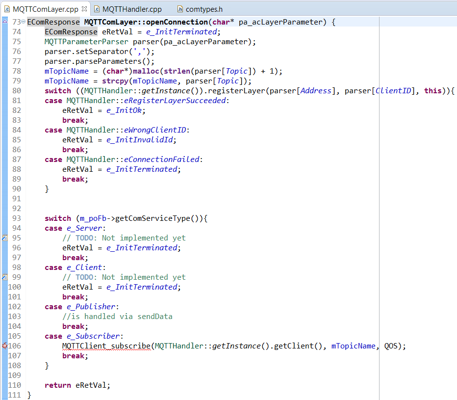

I made the following code change in MQTTComLayer.cpp as previously both eWrongClientID and eConnectionFailed where being turned into eInitInvalidId to try to debug my case and compiled FORTE again with the same cmake configuration:
MQTTComLayer.cpp (lines 73-109)
This should not have fixed the problem, I think I must have had something not properly compiled previous times. The change may be interesting to keep for future versions though. The setup is properly working without the use of FBDK.
[Updated on: Thu, 16 March 2017 05:44] by Moderator
