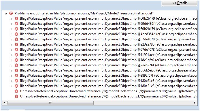

I can open my .model file in `Exeed Editor`. But when I want to open it in `Sample Reflective Editor` it has bellow errors. What should I do?

It looks like dynamic instances are being used; ones that don't match what the model is expecting. But I can only guess so much from a screen capture with no information about your model or what the instance serialization looks like.

thanks for your response. I attached my file.

It seems better to ask on the https://www.eclipse.org/epsilon/forum because they'll be the ones that register packages (or not) for the namespaces used in your serialization.
