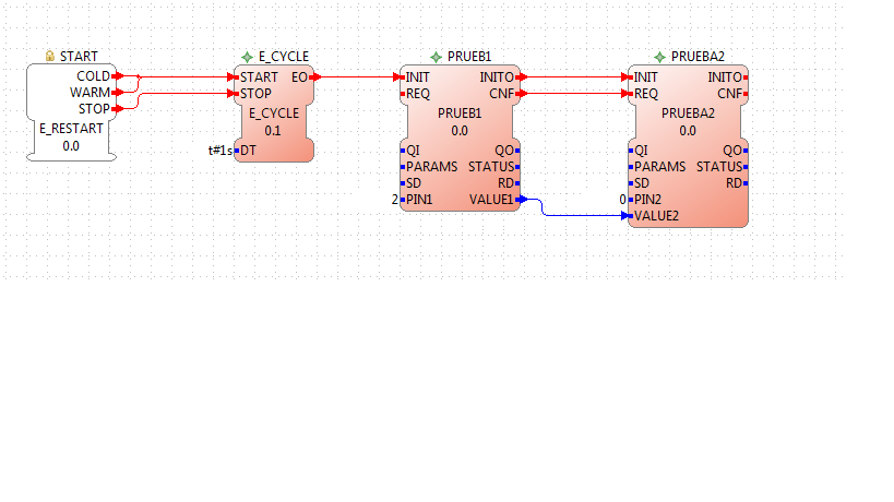

I want to create new function blocks to control the digital inputs and outputs of the raspberry, when creating a function block if I can use the digital inputs and outputs, but when I create two FB one to declare the input pins and another to execute the process does not work, I do not know what is the problem, my code is bad or maybe I should also schedule the events.
I want to send data of type BOOL from one FB to the other, as I can do.?
Attached my code,
Thank you
Gustavo

As stated in my other comment please consider using the existing IO FBs. If you wan to develop your own FBs please have a look on the tutorials in the 4diac docs. Especially the flip-flop tutorial should be there for you.
