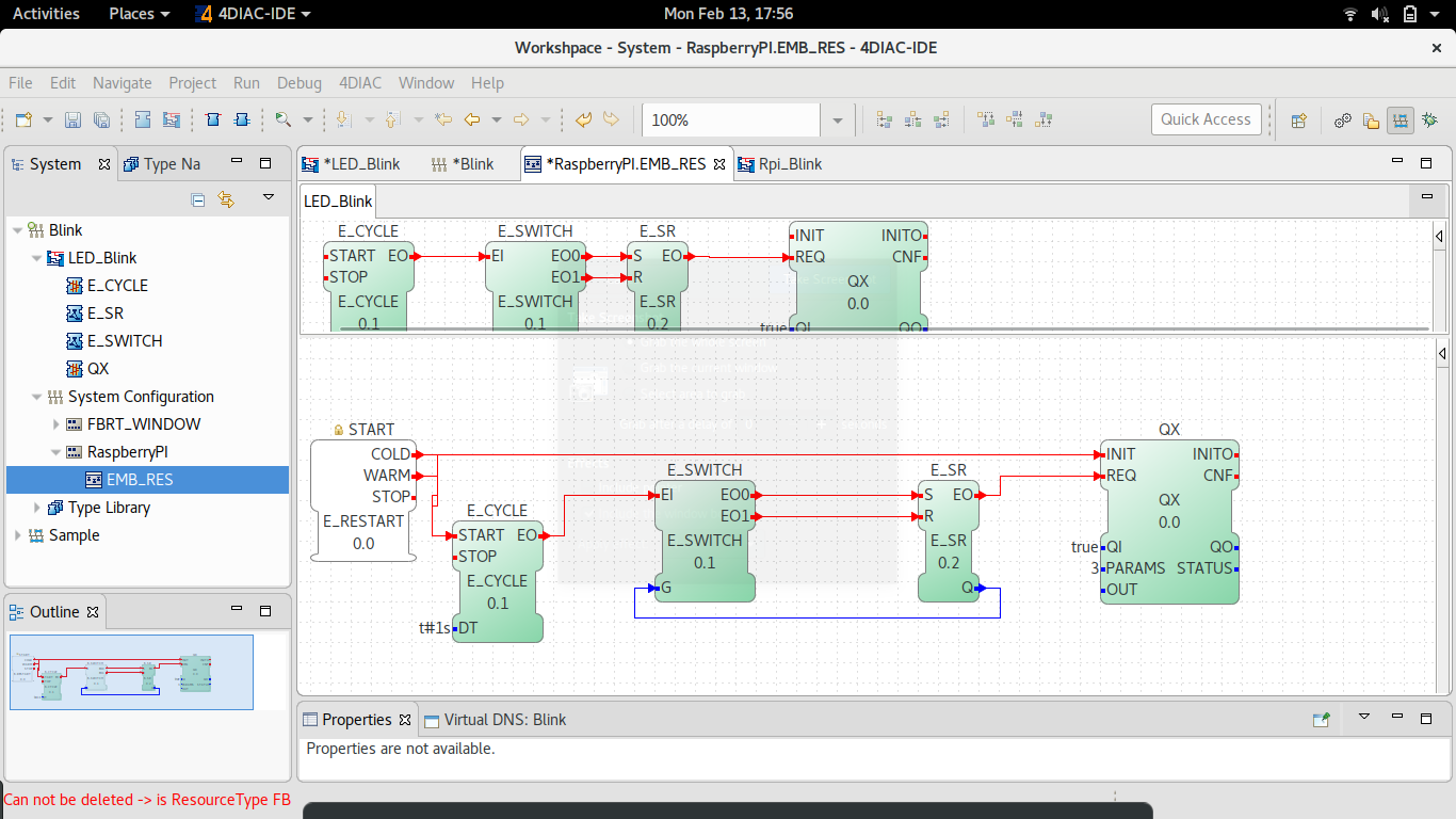

Made an application to blink led on GPIO 3 (Pin 5). Referred an example in https://www.eclipse.org/forums/index.php/t/1075043/. I have attached the image for reference.

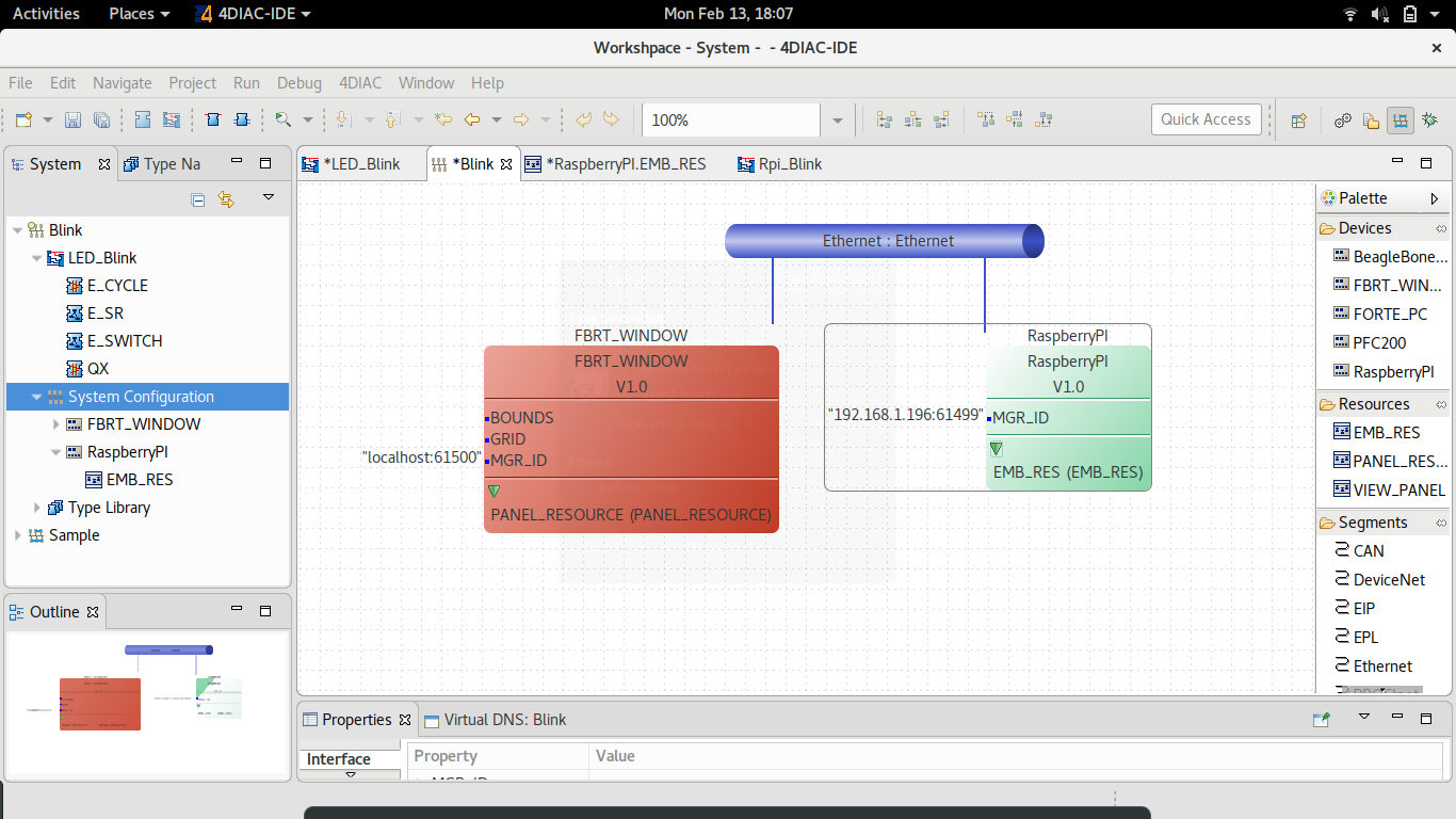

Defined system.I have used ethernet segment in 4DIAC although I am connected via WiFi.Again,I have attached the image for reference.

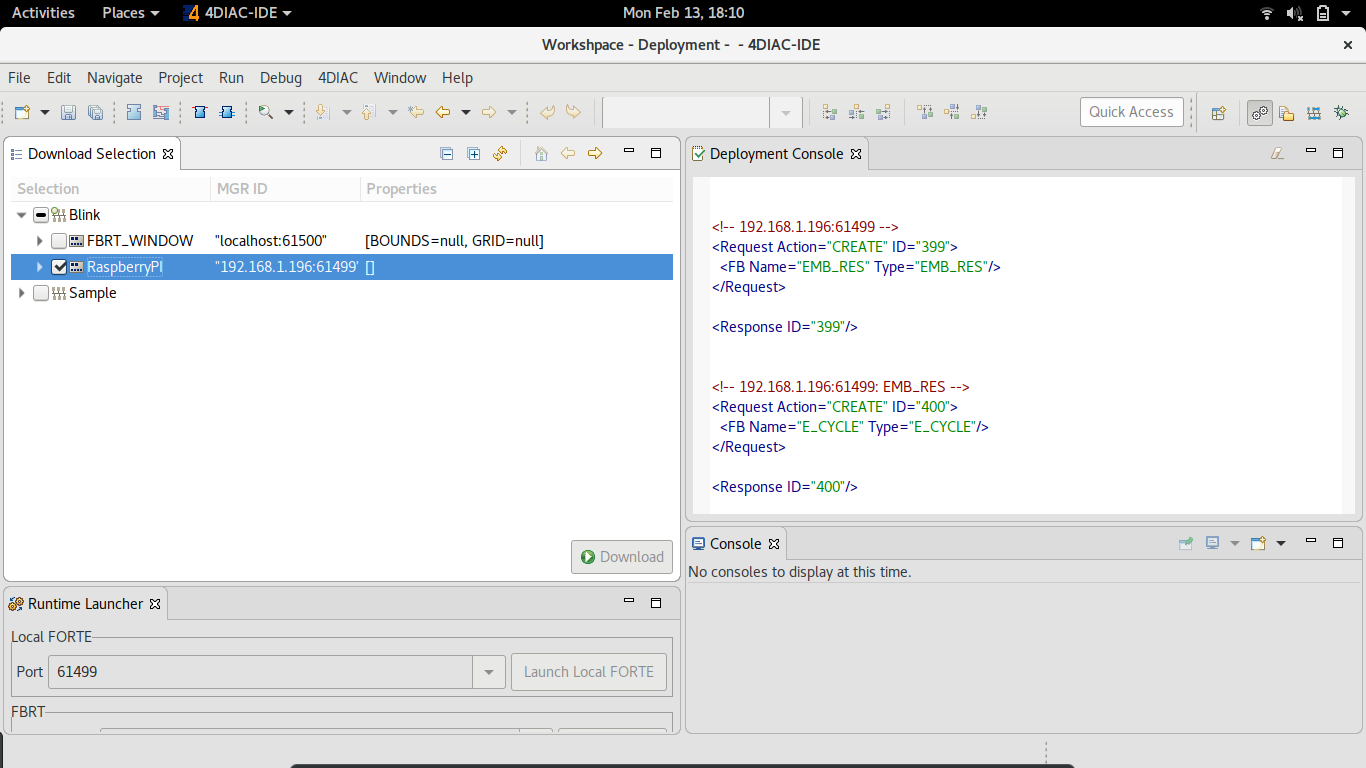

Deployed the application with no errors. (had to restart forte and then uploaded.During upload no status update was shown in shell(forte) but upload was shown complete in 4DIAC IDE)

Hi Akshai,
in the application which you have attached one data connection between the dataoutput "Q" of "E_SR" FB and datainput "OUT" of the "QX" FB is missing.
Regards.
Waldemar
Re: [HELP] Raspberry Pi GPIO Usage- Beginner [message #1754055 is a reply to message #1753962] Tue, 14 February 2017 03:13 Go to previous messageGo to next message
You must connect the Q output of SR to the OUT input of QX.
The OUT data input of QX is the value written to the hardware. If something is not working, you can right click on your project and click Monitor. Then a right click on a FB or variable and Watch All/Watch will allow you to see the current value of it.

Thank you all for the quick reply. I have connected the Q output of SR to the OUT input of QX but still the GPIO value in Pi is not changing after download. Please find the attached images with state changes of function blocks.http://i.imgur.com/6d6lCXg.png
http://i.imgur.com/46TwSMF.png
