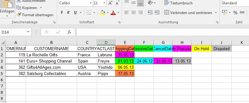

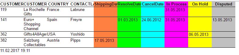

I'm struggling with XLSX output. I attached a little classic models example report to show the problem as well as two images.
Basically the report is a list of customers (in the real reports it is a list of projects). Each project (customer) contains milestones (orders) of a certain category (order status). Only the latest milestone per category is relevant (latest order date per status) for the report. The classic model data example does not make much sense, but data model wise it fits.
In the report I work with sub reports (a nested table within the detail row of the customer table). One column per status. Per data parameter binding I hand over customernumber and set a fixed value for status. As you can see in the image "output_html_fine.JPG" and when running the report it works the way it is supposed to.

However, if I run the same report via the XLSX emitter the data result content of the nested tables gets shifted, see image "output_xlsx_shifted.JPG".
index.php/fa/28413/0/
I tried lots of formatting stuff (e.g. cell paddings, more girds) and labels with a space in the same cell as a nested table without any success to make the XLS output display correctly. I also tried to assemble the data in one data set via joined data sets, but that did work because the original project list data set (customer) actually contains a report parameter where the user could chose what kind of projects are included in the report (closet analogy in the classic models data would be customer country). In the real report I got:
