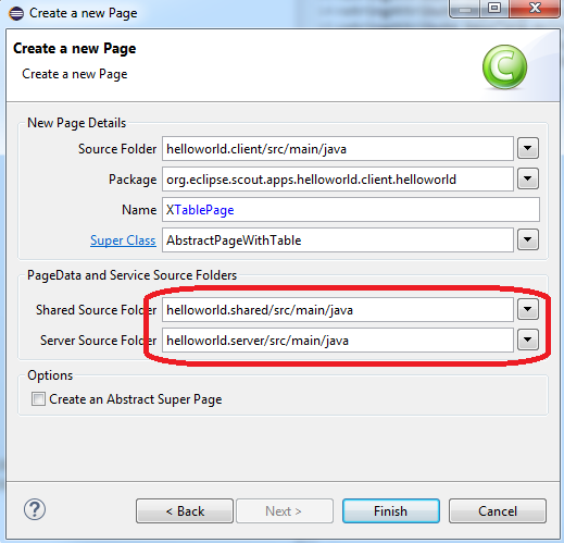

It works on in my workspace for the hello world:
index.php/fa/28407/0/
Without having access to your workspace it is hard to tell.
Which version of Eclipse IDE / Scout are you using?
What is your OS?
Have you changed something in the projects structure?
Do you see something in the Eclipse Error Log View?
Have you the possibility to share your workspace or to reproduce the problem in an other workspace that you can share?

I hunted down the problem in the SDK sources. I managed to discover that Scout SDK identifies shared, server and client projects by checking if Scout runtimes are available in this project:
boolean clientAvailable = S2eUtils.exists(javaProject.findType(IScoutRuntimeTypes.IClientSession));
boolean serverAvailable = S2eUtils.exists(javaProject.findType(IScoutRuntimeTypes.IServerSession));
and so on.
Problem in my workspace was a mistake in my shared project's POM I made myself which caused the client runtime to be included everywhere. That's why all my projects werde identified as client projects and thus not to be listed in shared or server source boxes.
