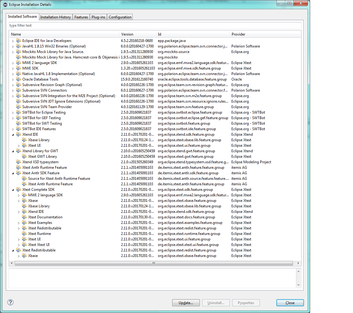

Re: After Migration 2.10 -> 2.11. Cannot start application [message #1753818 is a reply to message #1753813] Fri, 10 February 2017 06:52 Go to previous messageGo to next message
I've checked version of installed plugins via (Help->Installation details).
Look at attached screenshot
All version of plugins from XTEXT framework is 2.11
UUPPS : I found the reason in Run Configuration in plugin section there were two libraries 2.10 and 2.11. I've checked out old library. Problem is fixed
