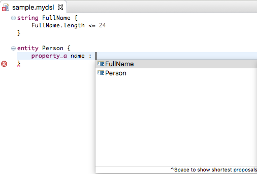

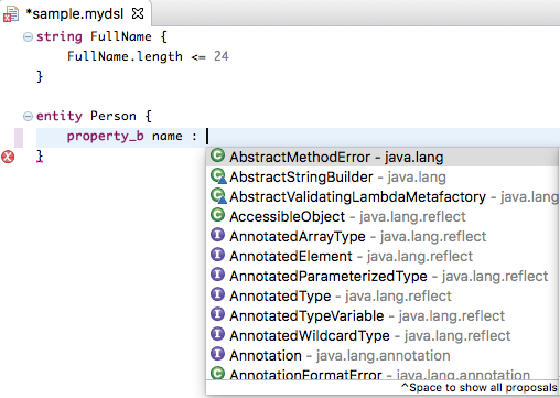

In the standard Domainmodel example, most of the types are specified as JvmTypeReference. IJvmModelInferrer may be simple or standard. However, when it comes to content-assist in the generated editor, it provides too many choices (see TypeB attached).
We would rather prefer to use TypeA Property so that we can get better content-assist in the generated editor (see TypeA, attached). However, I was not successful to make this work with IJvmModelInferrer.

Sorry I forgot to include images.
  • Attachment: typeA.png
    (Size: 26.96KB, Downloaded 128 times)
  • Attachment: typeB.png
    (Size: 83.36KB, Downloaded 113 times)
