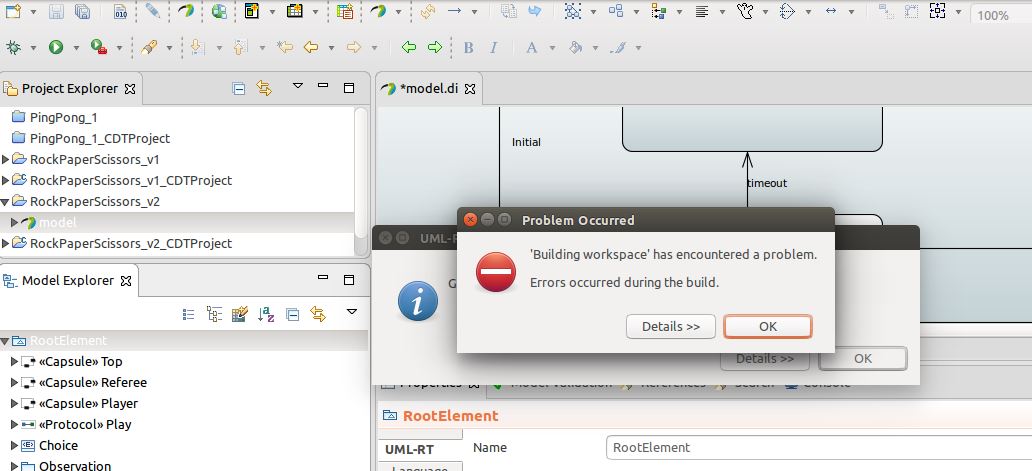

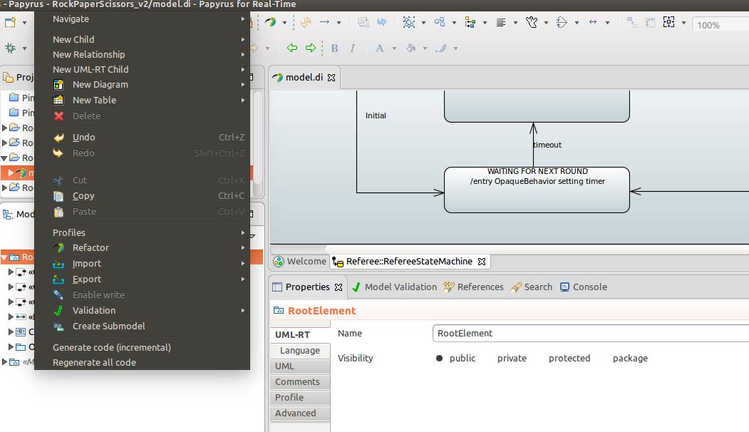

In Papyrus-RT version 0.8 if we change anything in the model and try to "Regenerate all code"
index.php/fa/28335/0/
then sometimes we get two errors: first we get an error "Building Workspace has encountered a problem" and second error is "Top Capsule not found".
index.php/fa/28336/0/

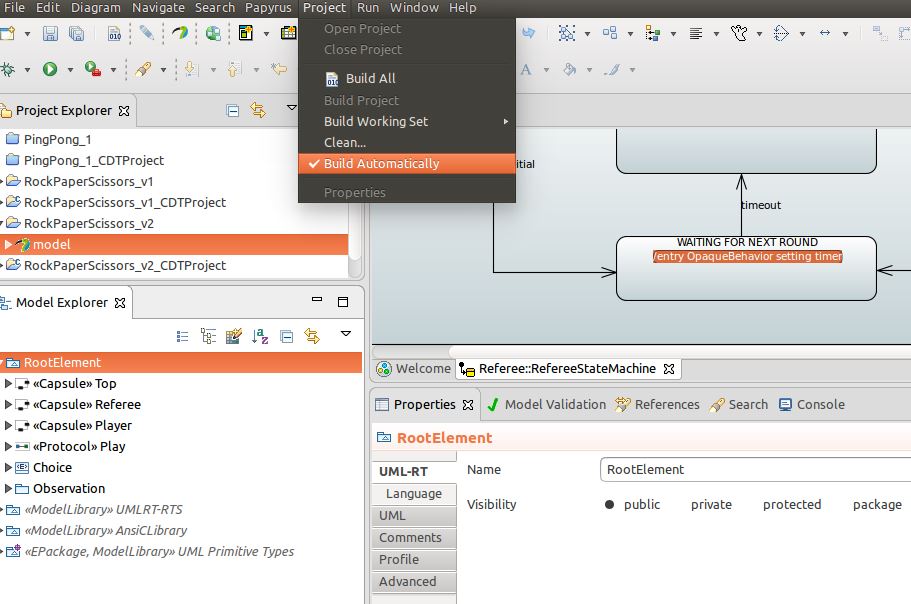

After some changes in options of Papyrus-RT I found that, If I disable "Build Automatically" function of Papyrus-RT then these problems do not occurred. To disable "Build Automatically" go to "Project" in menu bar and uncheck "Build Automatically".

Thanks for reporting this. We are aware of these problems.
They are in fact separate issues.
First, the "Top capsule not found" is a known bug (see https://bugs.eclipse.org/bugs/show_bug.cgi?id=511247). Until this bug is fixed, the only workaround is to close the model and reopen it.
The problem with "building the workspace" is not actually a Papyrus-RT bug but a bug in the CDT. Unfortunately we cannot do anything about it, as we do not control the CDT.
Disabling the "Build automatically" will spare you these errors, but you may encounter them again if you build your workspace. Also, if you disable them then you will loose the synchronization between CDT editors and Papyrus-RT models, if you use it (this is, when you select a state or transition and choose Edit effect, Edit guard or Edit action, a CDT editor will open where you can directly edit the associated code, and this will be synchronized with the model, as long as "Build automatically" is checked).
