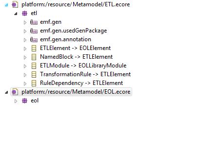

My source meta-model has two parts which links together.
When I want to transform an element of second part of this meta-model, it doesn't have error but nothing create in output. What can I do?

For clarify, I have below meta-model.
index.php/fa/28380/0/
Re: two parts metamodel [message #1753760 is a reply to message #1753740] Thu, 09 February 2017 14:30 Go to previous messageGo to next message
If you specify ETL.ecore as metamodel, ATL will also load any metamodels it refers to (I.e. EOL.ecore).
Re: two parts metamodel [message #1753778 is a reply to message #1753760] Fri, 10 February 2017 00:58 Go to previous messageGo to next message
I specified ETL as metamodel, but when I write e.g. "MM_ETL!AssignmentStatement" in the from part of my ATL rule, no element create in the output. if I change "MM_ETL!AssignmentStatement" to e.g. "MM_ETL!TransformationRule" or anything in the ETL part the elemet create in the output. I use version 3.6 of ATL.
