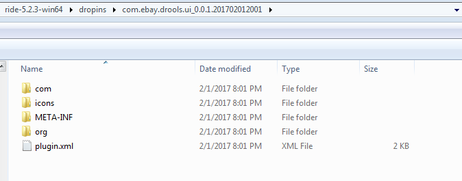

I was working on developing an eclipse plugin and dropping it in the dropins folder. It was working until Last Friday, but suddenly it stopped working.
Dropping the plugin in the plugins folder does not work either.
I have tried various suggestions on stackoverflow and other web sources but still same issue. Plugin does not load, it does not show in the plugin registry.
The folder structure of the plugin is attached.

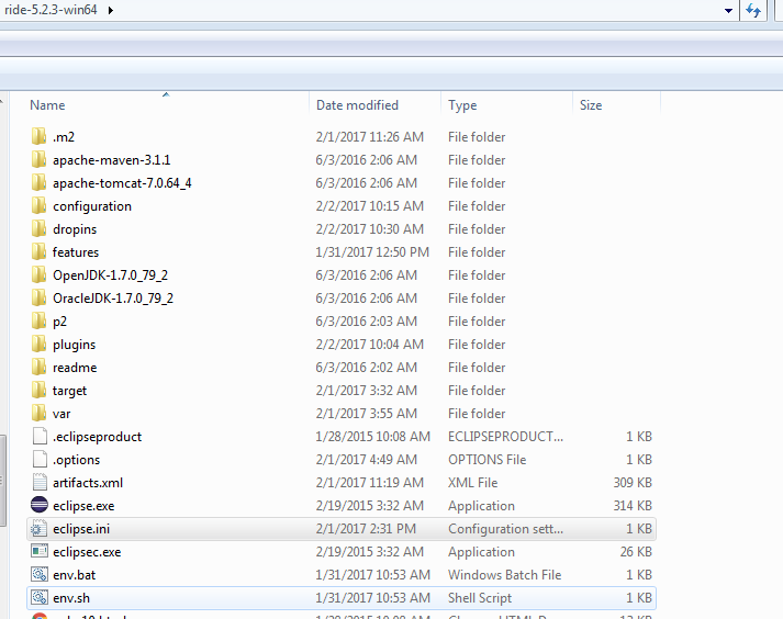

I am running on eclipse Luna. The plugin is dropped in the dropins folder of the Luna instance.
The plugin was develped on SDK4.6 (Neon), compiled against Java 7. The plugin is dropped into a Luna instance with required osgi set to Java 1.6 in the eclipse.ini file.
The eclipse Luna I use is a packaged version of Luna eclipse which has a "flat" folder structure (there is no "eclipse" folder). See attached screenshot.

I looked carefully at the logs, it seems the version 2.0.0 dependency for javax.ws.rs.client could not be satisfied. I removed ithe version dependency from the manifest file, now ithe plugin loads.
