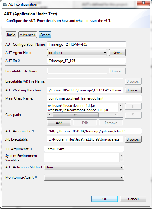

Sorry to hear you're having problems. Can you remind us what kind of AUT you are testing (swing, rcp, ...) and can you post a screenshot of your AUT configuration?

I am missing the 'Main Class Name' and the Classpath in the AUT configuration in Jubula 8.4. I'm afraid that's the reason why i can't get it working...
I always specified a Main Class Name and a Classpath with a set of jar's in the AUT configuration. So, the important question for me is now 'How can i get this working with Jubula 8.4?'

We removed the fields for main class name and classpath since we figured that most (all) applications now can be started via a jar or executable file.
Do you have a jar or an e.g. exe / cmd / bat for your AUT that you can use in place of the main class and classpath in the AUT configuration? That would be the best thing to do.
Alex
Re: AUT does not start with Jubula 8.4.1.123 [message #1753445 is a reply to message #1753444] Mon, 06 February 2017 10:08 Go to previous messageGo to next message
Looking at your screenshot - you will definitely need to enter either the executable file or the jar file. One of the two is needed to start an AUT.
Re: AUT does not start with Jubula 8.4.1.123 [message #1753450 is a reply to message #1753445] Mon, 06 February 2017 10:28 Go to previous messageGo to next message
