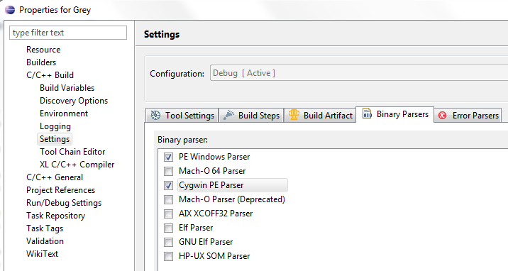

Binary parsers are configured in project properties:
index.php/fa/28301/0/
If it's binary parser issue, then the right way to solve it is by adding Cygwin ELF Parser to Eclipse/CDT.
