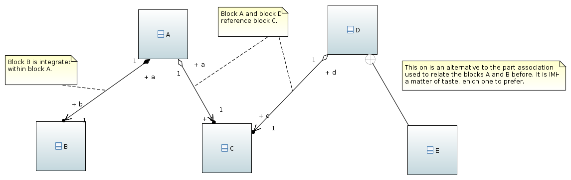

As far as I understand the SysML specification Papyrus behaves as intended in your case. Internal block diagram as expressed by "internal" are intended to show the internals of a single block, not hierarchies of blocks.
I personally express hierarchies of blocks using associations between blocks within a block definition diagram. I attached a diagram as reference.
index.php/fa/28325/0/
