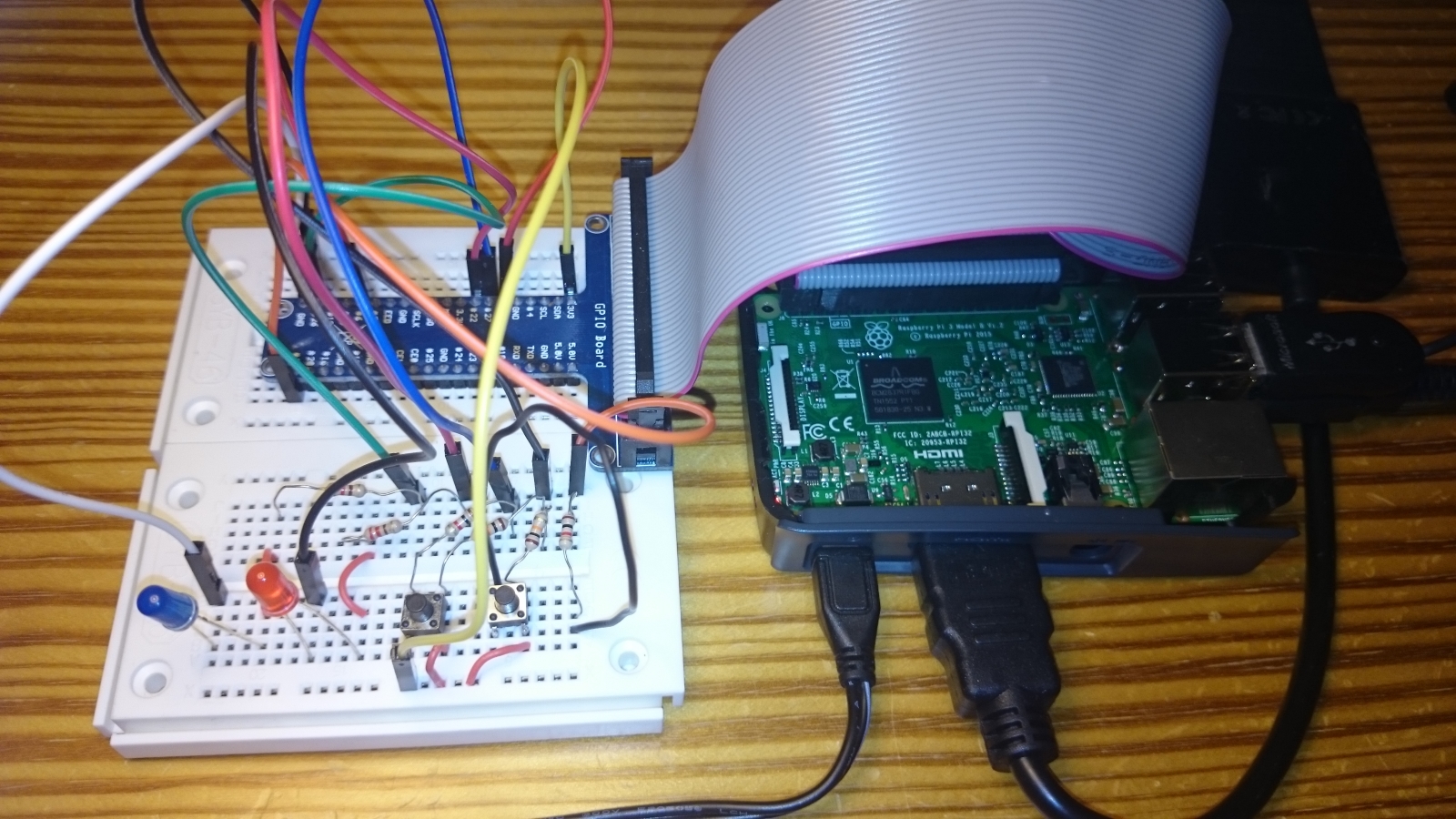

This code has been tested with LEDs and switches ( see picture),
index.php/fa/28266/0/
but a similar code can be used to drive simple home automation circuits,
LEGO motors (with an appropriate driver which supports current etc. requirements), you name it; also, a language course exemplifying usage of TTCN-3 can be built around this setup. It's a low cost and simple alternative to get familiar with the language and with Titan.
