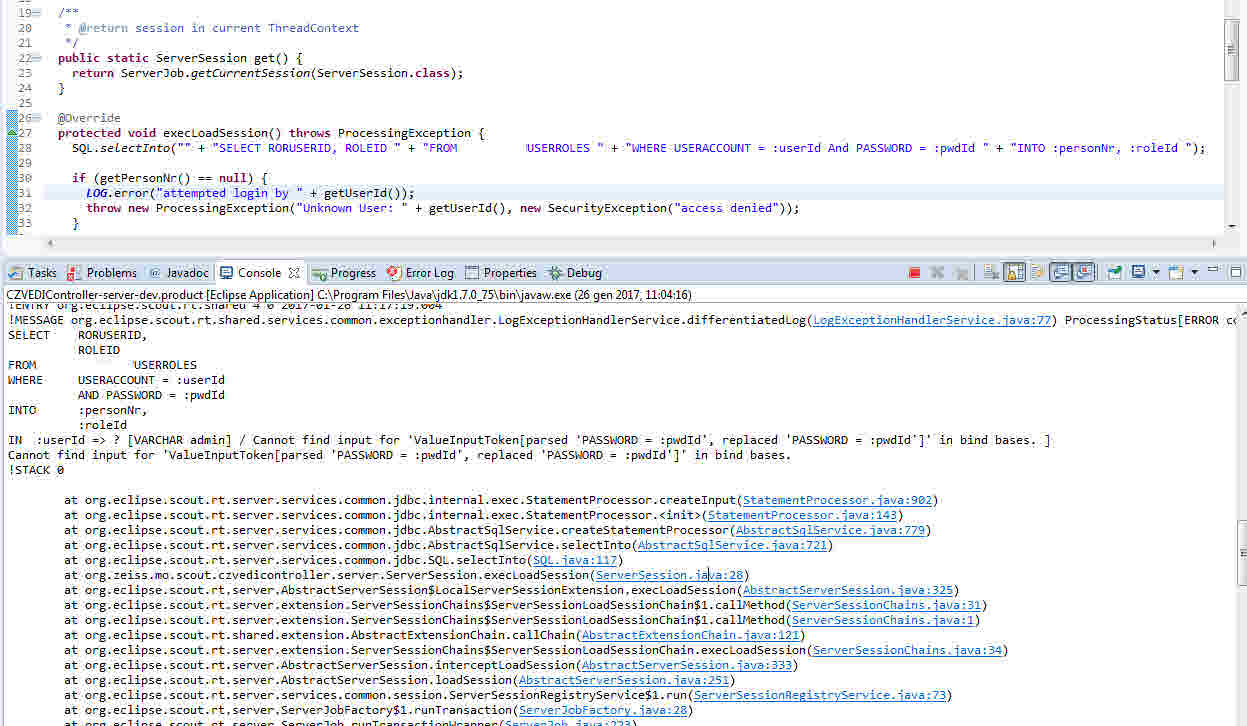

On the server side don't reconize the password, as you can see in the following image:
index.php/fa/28229/0/

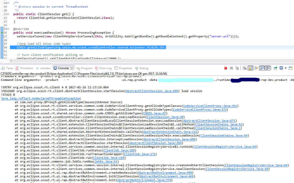

On the RAP side, obviously, can't procede to the initialization:
index.php/fa/28230/0/

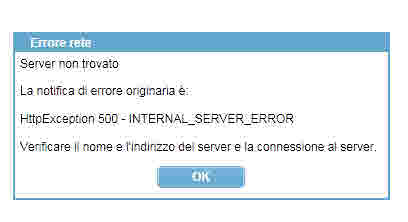

and on Internet Explorer return this:
index.php/fa/28231/0/

I notice that you aren't passing any SQL bind parameter arguments into your select statement (on ServerSession line 28).

Re: [mars] RAP + DataSourceSecurityFilter [message #1752782 is a reply to message #1752779] Fri, 27 January 2017 04:04 Go to previous messageGo to next message
I'm not the one to say, but I don't remember there being major differences in this area.
According to your log file, the failure happens on line 28 because the bind parameter pwdId is missing in the SQL bind context. If that same code was running on Kepler, then it must have been available as a context variable but isn't any more in your Mars version. Possibly the part of the code which sets the pwdId value in the context isn't being executed, or maybe is but in a different order (i.e. after execLoadSession)? Can you verify in your code where this is set?
Re: [mars] RAP + DataSourceSecurityFilter [message #1752811 is a reply to message #1752782] Fri, 27 January 2017 09:55 Go to previous messageGo to next message
Thanks for your suggestions, help me to find the stupid error and solve it.
