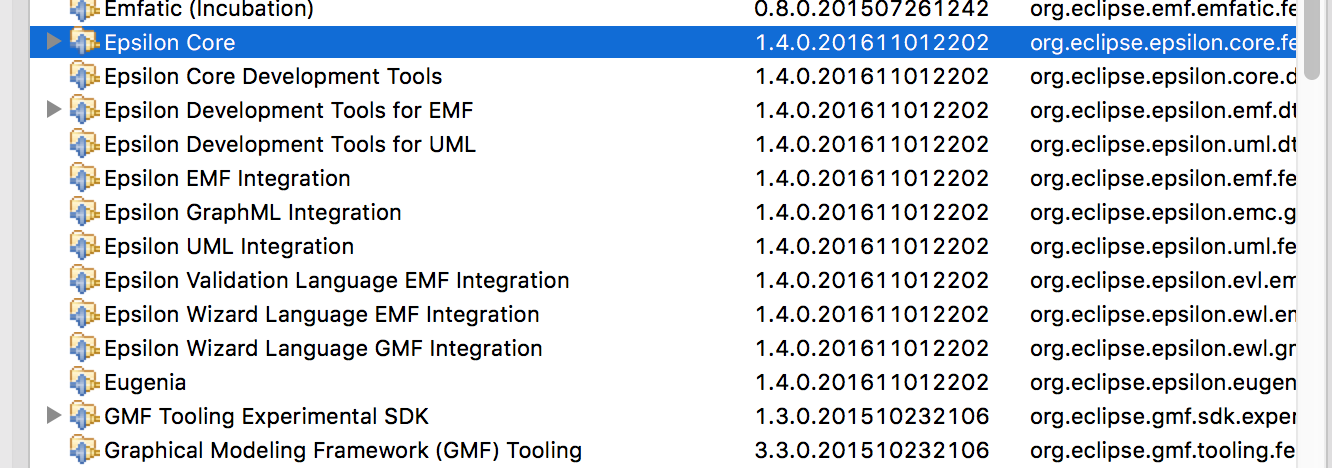

Re: Getting all objects with EGL [message #1752711 is a reply to message #1752690] Thu, 26 January 2017 07:22 Go to previous messageGo to next message
My Epsilon version is:
index.php/fa/28232/0/
