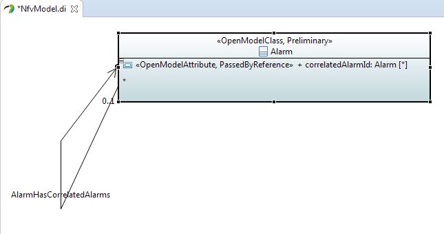

I have a class containing a navigable assocation end, coming from a previous version of Papyrus.

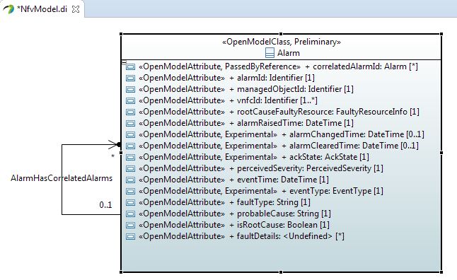

As I have added an attribute, I had to use Filters -> Show/Hide Contents to hide all attributes. The atribute coming from the navigable association end remained in the class.

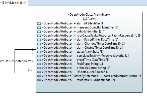

When I use the same command to show all attributes, the navigable association end became the first attribute of the class.
I am ataching 3 screen captures:
1- class before change; the association end is the one before last attribtue
2- Hiding all attributes, onyl the navigable association end stays
3- Showing all attributes, the navigable association end is first.
Re: UML Class Diagram attributes compartment issue [message #1759028 is a reply to message #1758652] Wed, 05 April 2017 08:04 Go to previous messageGo to next message
