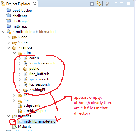

I'm having a C/C++ project for which I'm adding include paths (for the indexer to 'see') under C/C++ General ->Paths and Symbols -> Includes tab. Opening the Project Explorer view I can see those were added by looking under the "Includes" entry under my project - BUT they appear empty - cannot be expanded as if they contained no header files (*.h). More over, the actual problem is that the indexer behaves in the same manner, as if those files don't exist.

I've attached a screenshot of the Project Explorer view.

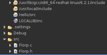

Project view does that. I don't know why. It has nothing to do with Indexer operation as far as I can tell.
I'm having no Indexer problems with this project but do have empty include folders in Project View.
index.php/fa/28171/0/
You could try using the Include Browser if you are interested
http://help.eclipse.org/neon/topic/org.eclipse.cdt.doc.user/reference/cdt_u_include_browser_view.htm?cp=8_4_0_14
Note that a question mark will appear in the margin for files the Indexer can't find.
