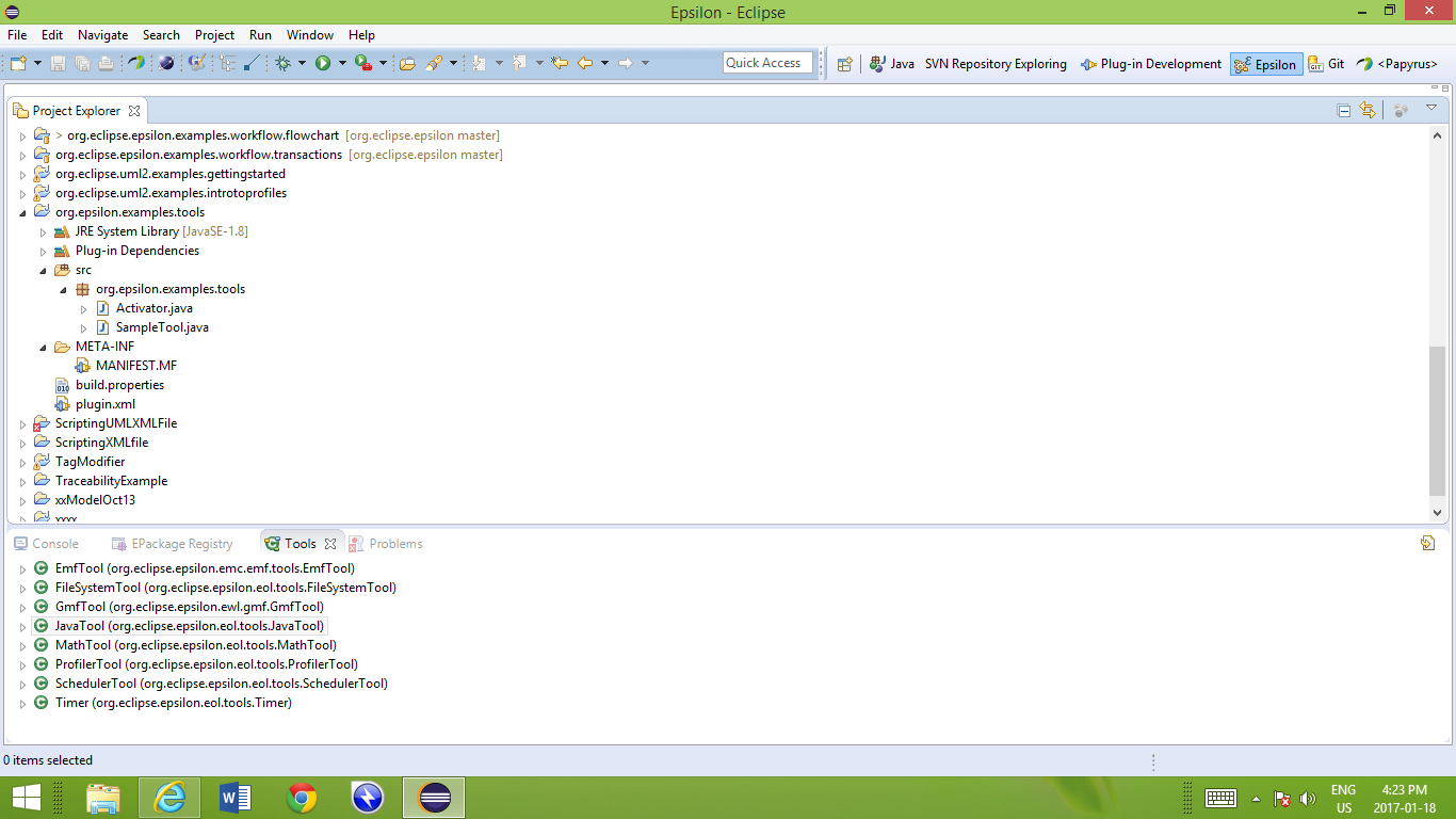

I followed the example that is available here https://eclipse.org/epsilon/doc/articles/call-java-from-epsilon/
It was working fine but I don't want to run the tool as an eclipse application then create a new EOL file because I am already have an EOL file in the Epsilon environment and I want that EOL to call the tool that I have created like the above tutorial .I tried to search the tools but I couldn't find it there .What should I do to allow my current EOL to call the tool that I created instead of creating a new EOL file .I hope that I have explained the problem clearly .Attached screenshot for what I have.

Re: call java tool from epsilon [message #1752148 is a reply to message #1752108] Thu, 19 January 2017 04:24 Go to previous messageGo to next message
Tools are contributed by plugins, so you need to have it installed in your Eclipse to use it (hence why you have to run a nested Eclipse application if you're using it from source).
You could try exporting the tool as a deployable plugin (using File > Export...), placing the .jar file inside the dropins folder of your Eclipse installation and then restarting Eclipse. You would need to redo this every time you change the tool, however.
