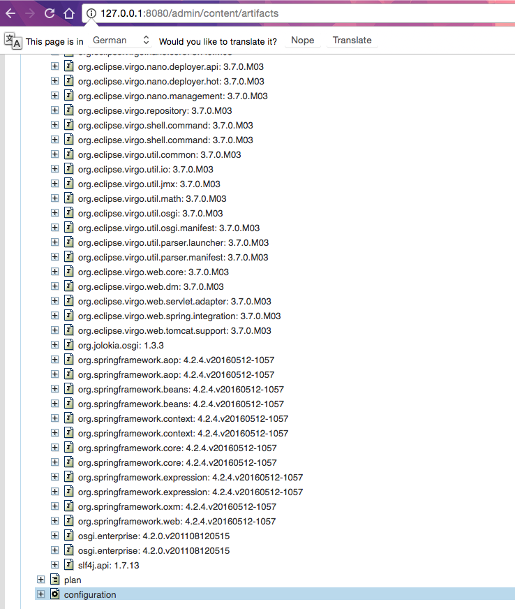

I then decided to check the Eclipse console of a freshly download Virgo 3.7.M03 without any application deployed and after starting it I've noticed something that seems weird to me, all springframeworks artifcats are deployed twice, see screenshot attached.
Am I missing something? Is there a problem with M03?

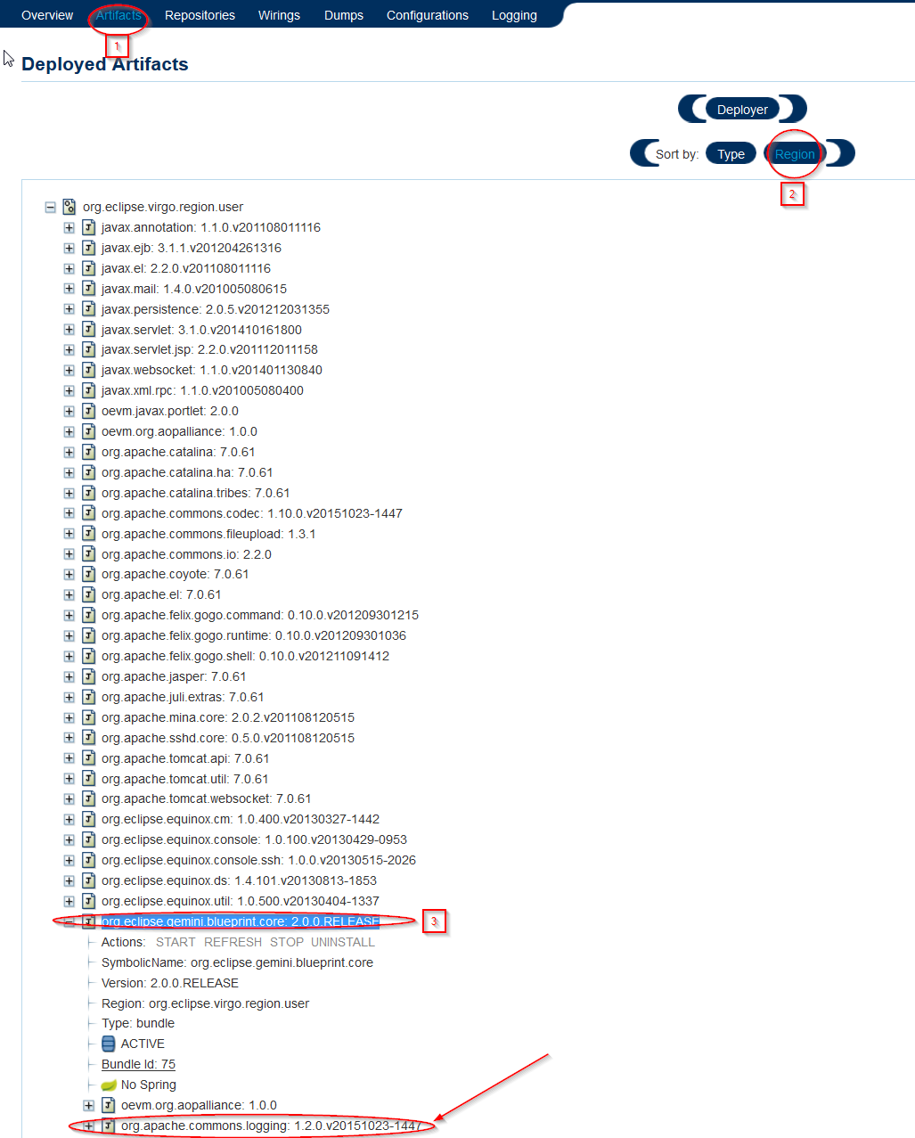

Re: Multiple spring deployments on Virgo 3.7.M03? [message #1751450 is a reply to message #1751445] Tue, 10 January 2017 08:45 Go to previous messageGo to next message
Matteo Cantarelli wrote on Tue, 10 January 2017 14:06
I'm trying to start migrating to Eclipse Virgo 3.7.M03 to move to Spring 4.2.x.
I'm getting a stream of Uses violation errors that we didn't have before with 3.6.4. I had to make some adjustments to migrate the spring schemas and remove the springframework libd which seems to be gone now but nothing to explain the following:
Did you add additional dependencies by your own?
The reason that you can see two artifacts of deployed of each Spring bundle comes from the fact that there is a kernel and user region. If you expand the nodes of this tree you should be able to see which is deployed to kernel and which to user region.
[Updated on: Tue, 10 January 2017 08:48] by Moderator

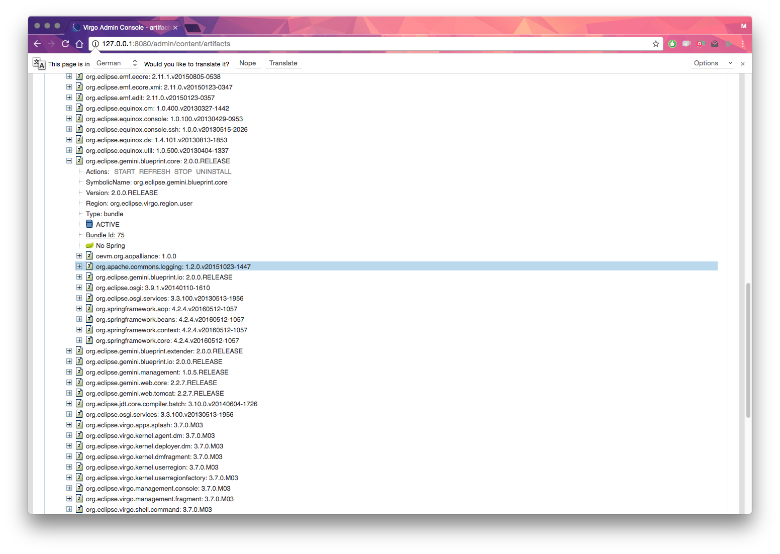

Re: Multiple spring deployments on Virgo 3.7.M03? [message #1751489 is a reply to message #1751454] Tue, 10 January 2017 12:31 Go to previous messageGo to next message
Looks like what triggers the uses violation is org.apache.commons.logging which seems to be exposed from the kernel region but also brought in by application bundles.
If I remove this dependency I have another error:
Context initialization failed org.springframework.beans.factory.BeanCreationException: Error creating bean with name 'velocityConfig' defined in ServletContext resource [/WEB-INF/spring/app-config.xml]: Instantiation of bean failed; nested exception is org.springframework.beans.BeanInstantiationException: Failed to instantiate [org.springframework.web.servlet.view.velocity.VelocityConfigurer]: Constructor threw exception; nested exception is java.lang.NoClassDefFoundError: org/apache/commons/logging/LogFactory
so it looks like the exported commons.loggins from the kernel region which is used by springframework is not somehow visible when org.springframework.web.servlet.view.velocity.VelocityConfigurer tries to use it? Ideas? Thanks!

Also when I start Virgo Tomcat Server 3.7.0.M03, go to the Web Admin Console I can see that org.apache.commons.logging: 1.2.0.v20151023-1447 bundle is active and used by org.eclipse.gemini.blueprint.core: 2.0.0.RELEASE bundle:
index.php/fa/28079/0/
Can you please check on your side if you can see the same?
Dani
Re: Multiple spring deployments on Virgo 3.7.M03? [message #1751498 is a reply to message #1751497] Tue, 10 January 2017 14:31 Go to previous messageGo to next message
I do, see attached screenshot.
https://www.eclipse.org/forums/index.php?t=getfile&id=28080&
I usually solve this type of problems adding an import package on the manifest but in this case org.apache.commons.logging is already there.
