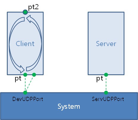

Hi Elemer,
I have modified your "myUDPadv.ttcn" to add dual-faced port but it does not work...
it is difficult to understand ports configuration between components and system.
Could you check the the code and log. Also image what I understand about dual-faced port? What did I do wrong?
Dae-young Kim
Re: ASN.1 messsage send/recv through UDP test port [message #1751553 is a reply to message #1751547] Wed, 11 January 2017 07:11 Go to previous messageGo to next message
Hi Dae-young,
replace myUDPadv.ttcn in Elemér's PREVIUOS package with the attached file. It changed to use a dual-faced port; after correcting a few inconsistencies in my previous version of the file, the server returns the received message, the client matches it and the test cases passes.
Best Regards, Gyorgy

Re: ASN.1 messsage send/recv through UDP test port [message #1751554 is a reply to message #1751547] Wed, 11 January 2017 07:15 Go to previous messageGo to next message
Hi Dae-young,
You did not attach the log file;
I'm guessing you did not change in the config file
from
*.pt.mode := "advanced"
*.pt.debugging := "no"
to
*.pt2.mode := "advanced"
*.pt2.debugging := "no"
which means pt2 was started with default , which is "basic" mode;
I have attached the working example; only client side uses the dual-faced port;
Best regards
Elemer
Re: ASN.1 messsage send/recv through UDP test port [message #1751627 is a reply to message #1751553] Wed, 11 January 2017 22:32 Go to previous messageGo to next message
Hi György,
Thank you for your check.
I am getting used to dual-faced port but I wonder how the component port act with system port by map().
Seeing your code, there is no declaration of system port - DevUDPPort, ServUDPPort.
How could it work? it is mysterious.
Re: ASN.1 messsage send/recv through UDP test port [message #1751629 is a reply to message #1751554] Thu, 12 January 2017 00:43 Go to previous messageGo to next message
Hi Elemer,
I am sorry I have missed log file.
Compared to György's code, you explicitly declared two types of system ports.
One is 'UDPasp_PT' and the other one is 'Dual_faced_internal_pt'. Also, client and server component have both. As I understand, these have mapping like below.
client((pt2)) ---> system((pt1)) --->((pt1))server
client((pt2)) <--- system((pt2)) <---((pt1))server
( let's call 'UDPasp_PT' as 'pt1' and 'Dual_faced_internal_pt' as 'pt2')
When client send something via (pt2) , it implicitly uses (pt1). System (pt1) will forward it to server.
After server received something via (pt1), server will send it to system (pt2).
At sytem (pt2) , 'ASP_UDP_message' will be converted to 'Message" and then sent to client(pt2).
I wonder whether this is right. Regarding role of system port, this is ambiguous point. Several reference documents explains that Test System communicate with SUT via system ports. How does system port work in my test scenario? Is it possible to check at C/C++ code level?
Re: ASN.1 messsage send/recv through UDP test port [message #1751646 is a reply to message #1751629] Thu, 12 January 2017 03:34 Go to previous messageGo to next message
Hi Dae-young,
sorry , I have created the confusion myself; what I intended to write was:
type component UDPDeviceTesterInterface
	port UDPasp_PT ServUDPPort;
        port Dual_faced_internal_pt DevUDPPort;
to express that client side uses dual-faced, while server side the simple UDP port.
Truth is, the system declaration does not affect the functionality (at least in Titan implementation ) and as such, is optional. It works equally well without it, or if it's messed up, like I did.
The reason I personally prefer to have it is that it offers a quick overview
of the SUT ports used (well, if it's done correctly). It may not matter much
for two ports, but when you have a complex set-up, with many components and ports/port arrays, it can get confusing.
The components in this case have two ports declared, but only one is used.
So mapping is like: client(pt2) ------dual faced port upper part ---dual faced port lower part ----server (pt1)
I hope this will clear the confusion
Best regards
Elemer
