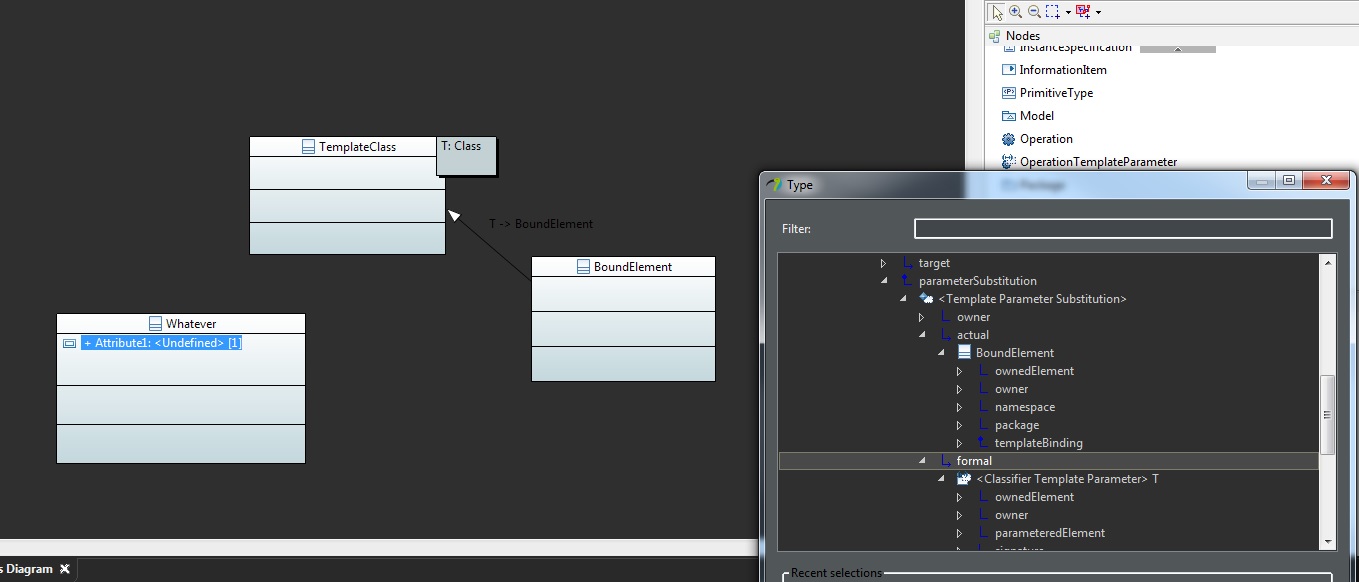

Re: User Model for C++ Template Containers [message #1763944 is a reply to message #1751788] Tue, 23 May 2017 05:26 Go to previous messageGo to next message
Dear Ansgar Radermacher,
first of all thank you for your answer.
As I think I already said in my original post, I did define a template substistution.
What I want is to use that now as a type to an Attribute.
Maybe the picture will make it clear, what I want to achieve
index.php/fa/29433/0/
As you can see, I did set formal and actual, but how do I make it, that I get the result Attribute1: TemplateClass<BoundElement>?
What do I have to choose in the type wizard window?
Thank you for your time and trouble.
Best regards
Philip.
Re: User Model for C++ Template Containers [message #1763974 is a reply to message #1763944] Tue, 23 May 2017 10:11 Go to previous messageGo to next message
Dear Philip,
if I interpret the figure right, you created a new class BoundElement which a parameter substitution with itself, i.e. T is replaced with BoundElement. This is not legal, as it would imply a circular substitution. You should substitute T by another class, e.g. MyActual. BoundElement is actually the type that would be written as TemplateClass<MyActual> in a programming language. It is a good idea to use a naming convention like TemplateClass_MyActual to clarify the nature of this class, i.e. I suggest to rename BoundElement.
Afterwards, you just type Attribute1 with the class TemplateClass_MyActual.
Re: User Model for C++ Template Containers [message #1764062 is a reply to message #1763974] Wed, 24 May 2017 09:30 Go to previous messageGo to next message
Sorry,
but I don't get what you are saying;
T is the template parameter of TemplateClass; I then created a new class BoundElement and a TemplateBinding from BoundElement to templateClass with formal = T and actual = BoundElement.
I want to bind BoundElement as a template substitution to the template Parameter T of templateClass.
I understood it like that is what does templateClass<T> -> templateClass<BoundElement>
like this
http://www.uml-diagrams.org/template.html#template-binding
Why is this a circular substistution?
[Updated on: Wed, 24 May 2017 09:42] by Moderator
Re: User Model for C++ Template Containers [message #1764198 is a reply to message #1764062] Fri, 26 May 2017 11:12 Go to previous message
I think I understood it now.
As the UML2.4.1-Specification says on page 632:
"The semantics of a binding relationship is equivalent to the model elements that would result from copying the contents of the template into the bound element, replacing any elements exposed as a template parameter with the corresponding
element(s) specified as actual parameters in this binding."
I always thought, this was a mistake, and actually the content of the bound element is copied into the template as a substitution for the corresponding template signature parameter, but it seems as if it is not that binding Bar to the template Foo,
the result becomes Foo<Bar>, but actually that assuming Foo is of the form Foo<Class T> and Bar has a template Binding to Foo with a template substistution T -> Blubs, then Bar = Foo<Blubs>.
So if I want Foo<Blubs> as a type of a property, I choose Bar as the type.
Oh, I see, you already said that in your answer, while I was too blinded to see it, my apologies.
[Updated on: Tue, 30 May 2017 09:44] by Moderator
