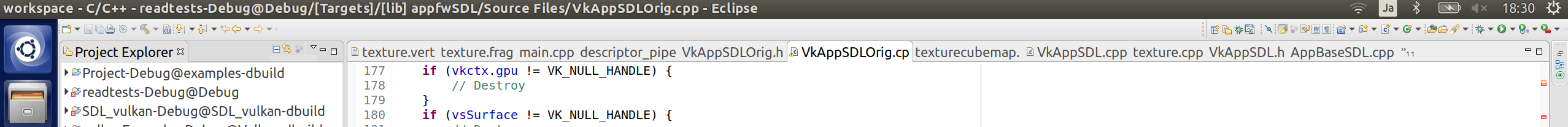

The problem only happens with GTK 3. GTK2 is okay except that only the top part of the icons is drawn until you run the pointer over them. This image shows this weird initial state.
index.php/fa/28051/0/

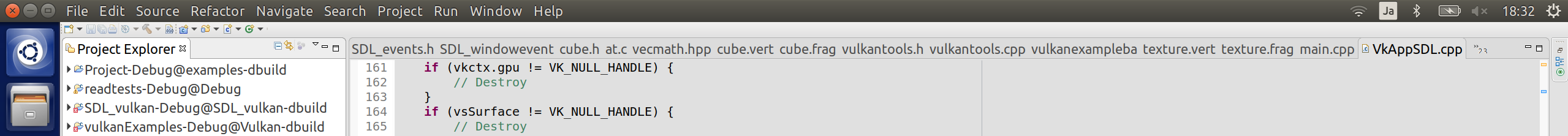

Here is a screenshot when running with GTK 3 and workspace.xmi does not exist. Be sure to look at the right hand side of the image.
index.php/fa/28052/0/

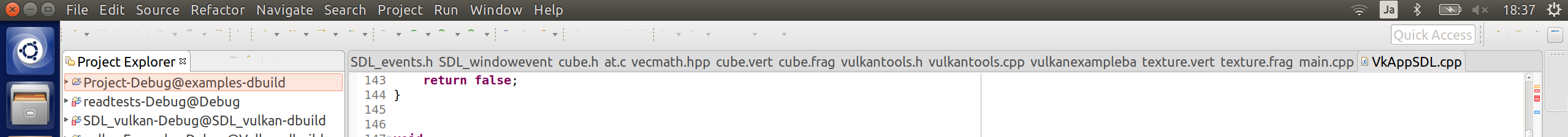

Here is a shot when workspace.xmi exists.
index.php/fa/28053/0/
