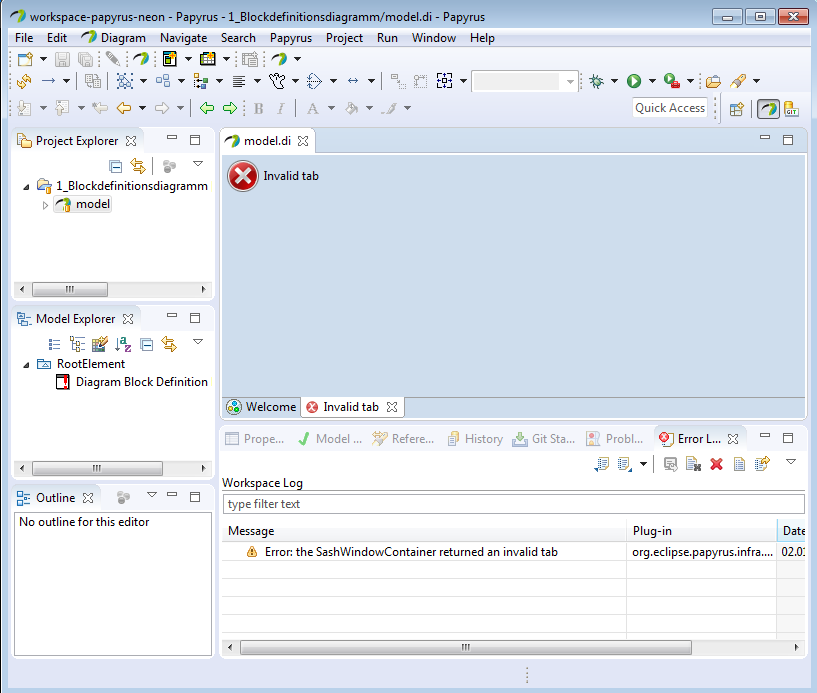

Hi there,
all my sysml models were created with papyrus (1.1.4) in eclipse mars.2.
Now, when I try to open one of those models with papyrus (2.0.1) in eclipse neon.1, it's not working.
All the models come from a git repo.
The "Papyrus SysML 1.4 Feature" (0.10.0) is installed.
On double-clicking the "model" in the project explorer, a "welcome page" opens, with a red exclamation mark(!) beneath the model name in the "Notation Views" section and the model language is displayed as UML 2.5.0 (see screenshot1.png).
When clicking on the model name a tab is opened saying "Invalid tab" and a message in the error log view says: "Error: the SashWindowContainer returned an invalid tab" (see screenshot2.png).
Funny thing is, sometime a migration dialog pops up, sometimes not.
But, no matter what I select, the outcome stays the same.
So, do I miss something?
I guess so.
But what?
Thx in advance!

Hi Stefan,
You need to Install SysML 1.1 component which was previously part of Papyrus core and is now available as an extra.
For the moment the SysML 1.4 is not able to open model created using SyML 1.1
Benoit

Hi Benoit,
thanks a lot!
Just installed it, and voilà, it works.
